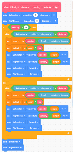

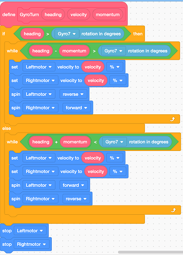

Just wondering if you have a dodgy gyro, whether that will affect whteher a P Loop works. By dodgy i mean if you program it to turn left for 90, i will go like 180, meaning the gyro is clearly wrong. If you have a gyro like this does that mean a P Loop wont work?

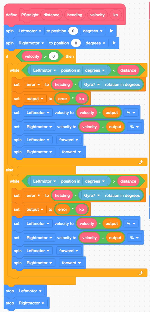

because almost invariably with coding issues someone left something out, so you can’t just say, ā€œIt’s Caution Tape’s,ā€ because you probably made an error that they didn’t. And by the way, kP should be a variable, like when you click Make a variable. It should not be something you type into every instance of your block.

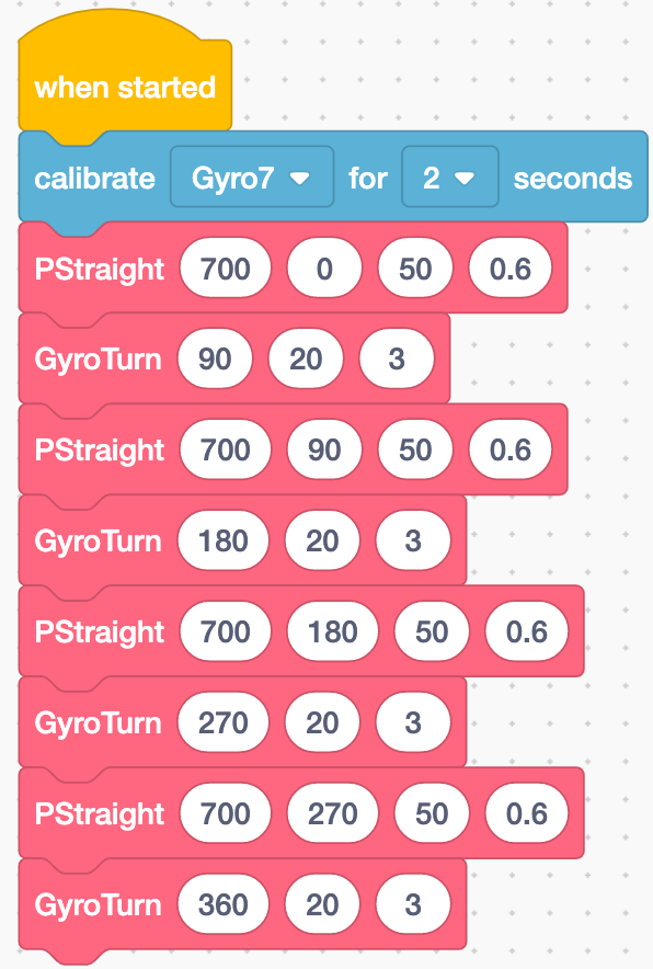

I programmed it to go foward 200mm and then turn right for 180 degrees, but then it ends up going like 260 degrees

The first two ā€˜spin’ lines on your Straight myBlock do not match Caution Tape’s code. I would suggest reviewing all of it before proceeding further.
