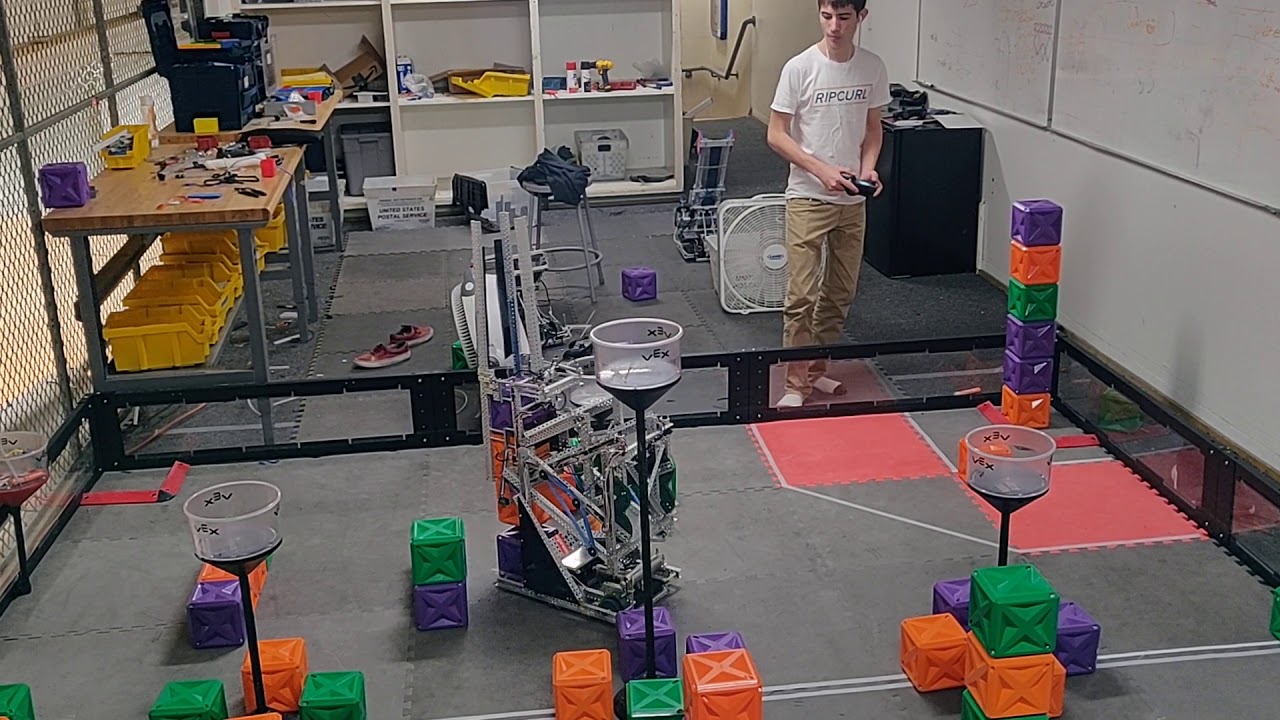

I think that you could do a double reverse six bar and make a claw to hold six cubes, with you being able to come on top and intake cubes like a tube bot, kinda like 3324v
This is a really good example of one:
that is basikly what i want out of my bot in the future thx

here is the current 4bar-6bar it is 2 inches to tall what should i do push the base down or shrink the middle linkage or extand the 4 bar?
Maybe just take off the 6 bar and make it a 4 bar as well
its not that it is the middle linkage betwene the 4 and 6 bar lifts that is to high

You could probably lengthen the bars for the lift and make it so that when all the way down, the middle tower is lower if you know what I mean.
i just did that thanks @alphagoats53999f it is now legal
