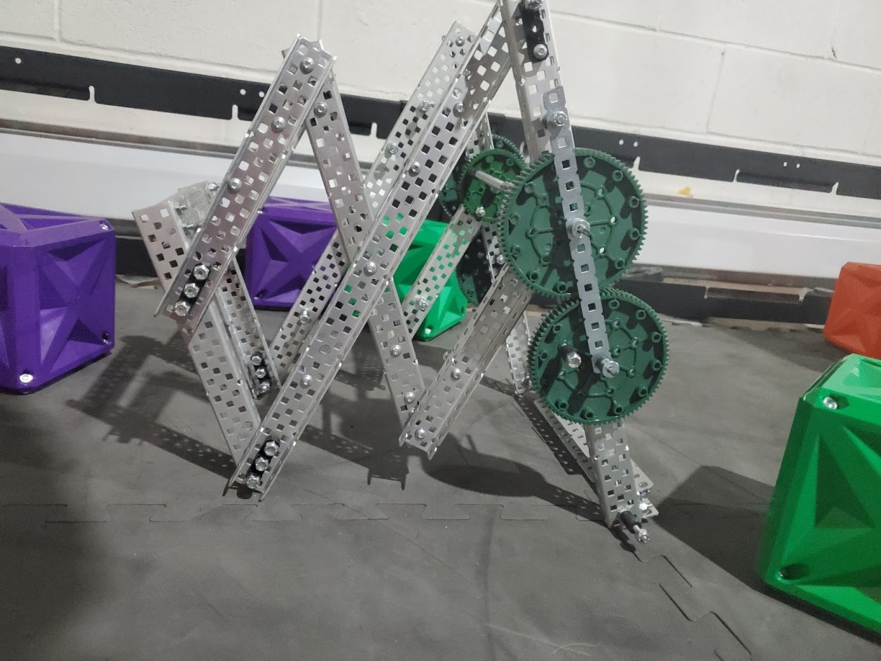

i am rebuilding my robot and i need help i have a few things already built and i was woundering if it would be helpfull to reincarnate them or build completly new things
4 steel c-channel for a 4 bar if need be
the bases for all my prior arms
old top of dr6b
the 6 bar i just used
my new mecknum base i just made
what should i do? thx in advance

Mechanum Omnis I may not be a great idea but for originality you could do a 6bar tray with strafing

Maybe but if you put a 4bar and a 6bar together you may be tippy
yeah i had that problem with a dr6b but that was my first edr build ever i tried some other insane stuff and i couldn’t get it to work but i have seen 1 or 2 good non tippy dr6bs

my coach has just weighed in aparently i am doing a 4bar-6bar
i would probably combine the first three images right?
and where would i start a 4-6bar in the middle or the front?
Honestly just build a complex tray bot. With your experience you should be able to make a good one (and there’s a reason they’re the most prevalent design).
With what you have at the moment, I wouldn’t suggest building a 4-6 bar. You’ll be very prone to tipping with your small base and it will get complicated quickly. Also if your coach is telling you what to build then you might be doing something wrong. Good luck! :slight_smile: :smiley:

thx @2775Josh but i would have to respectfully disagree complex trays cant do the high tower or intake vertical stacks and in my area at my first comp i went undefeated in quals with a 6 bar that could only pick up one cube because it can stack on top of an existing tray and scene all the good bots in my area except me are all trays with the exception of @alphagoats53999f and one other. i want to compliment a good traybot but still be able to decently stack so i could carry a pushbot in quals and work okay with another tower bot.
also i have been finals alliance partners with @Micah_7157X twice now and bolth his and my coach agree and dont think it would be best for me and @jrjohn2205 to build a tray of sorts. and about the coaching part i believe coaches should advise you on what to do but not HOW to do something
Well, if you are dead set on building a lift, then be sure to follow 333A’s tutorial, and maybe take inspiration from 21000C. As for your base, you will definitely need to add some wheelie bars to prevent your robot from tipping (or rebuild the base altogether). Good luck with your build!

also if i do any variation of a dr4b can i power it from the bottom or is it beter to do it from the middle
Powering from the bottom would make the dr4b even narrower which is not really that great. Now of course if your claw sticks out in front of the lift towers, then that should be fine. I still like putting motors on the lift tho
Well, no. With a base that narrow and a lift to reach the top tower your robot is pretty likely to fall over. And it is better to power your lift from the middle.
Cool. I’ve never been @'d in a post before. I would say that if you want to build one of these, a 20 hole base will be pretty difficult to antitip. Our base is just about max size and we can still put two stacks in the large zone and stack in the small zone. You just need to drive over the bump with one wheel and come in at an angle.
Also, awards aren’t a good thing to count on for state qualifications imo. It’s better to go for skills or tournament champion because those are things you can control, and don’t count on some stranger’s opinion. As long as you aren’t continuously going to competitions as competitive as chittenango and rome you have a chance with this design I think.
As the year goes on people will need a good tower robot so they can focus on all 3 stacks while you control towers the whole match. Some robots already can get 3 stacks of 9 in one match so having two trays serves no purpose.
