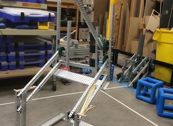

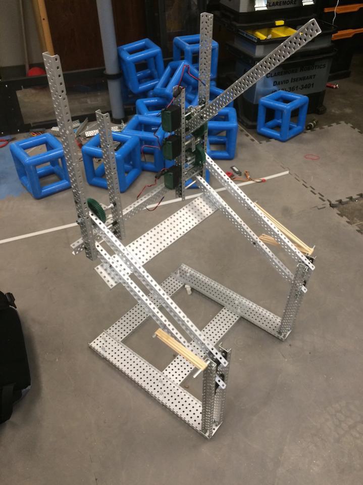

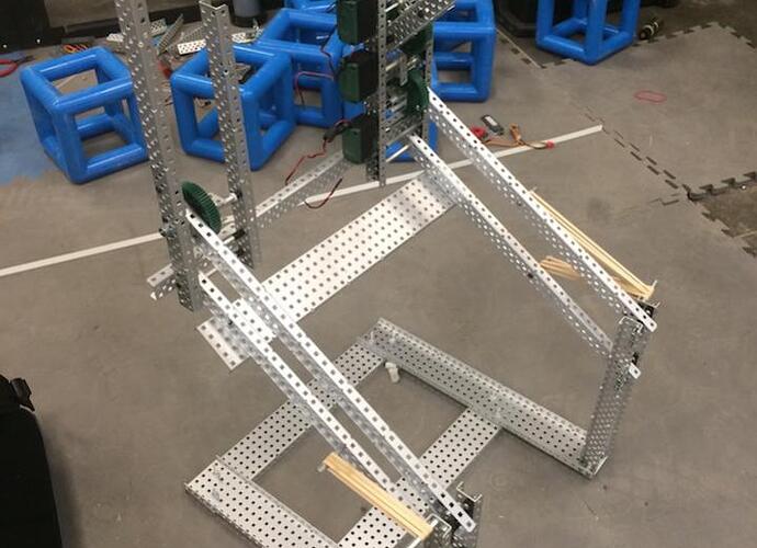

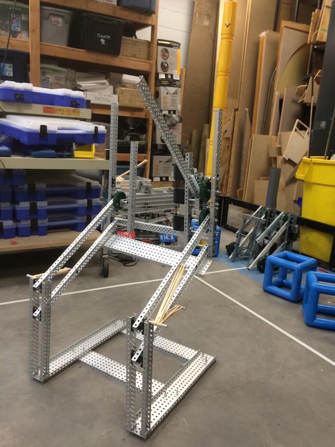

Alright, we got one side basically done, the rubber bands can hold it in place and lift it with basically no pressure at all. The only issue… It’s like 2 feet to short! Right now it’s like 4 pegs high and that’s way too short. How do you get the height more? I provided some pics, criticism only helps on this.
The small pieces of C-channel that you are using to bridge/bearing closer to your pinion gears is limiting your arm travel. You need to remove those.
How many cubes are you planning on lifting? I would do 1:7 and do 4 motor lift. The 84t gears will get you a little bit more height also.

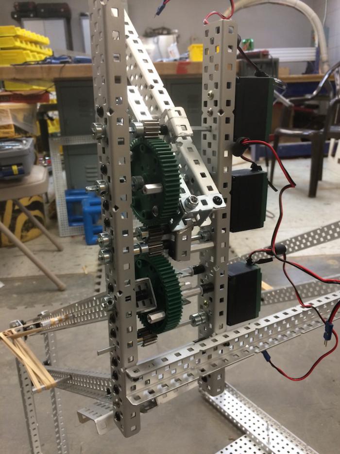

You need to space the arms out farther vertically on the middle vertical bar. We were able to sufficiently power ours with 4 motors and 6 orange rubber bands on each side. For our middle vertical bar, we used gears in this order vertically:
84T (top upper bar)
12T (top motor)
84T (top lower bar)
84T (bottom upper bar)
12T (top motor)
We only have the small 84 tooth not high strength, I made one by putting two together but they never seemed to line up and took a long time to make and it wasted a lot of time.

The use of the high strength 84 gear is almost a must. As a matter of fact my daughter’s robot has now doubled up two 84 high strength gear to decrease slop.
Cross bracing is key and can be tricky because of how everything folded together.

you can make it lift higher by baring the top gear to a 4 bar that is above that.
you may also consider gearing your arm like the one in the pic 1:15 with high speed giving it about a 1:9.3. (this is my teams robot). we can easily score on a 5high skyrise with 3 cubes and can build the 6th.

To make it even higher, you’re going to want the 4-bar members touch each other. It looks like the smakk pieces of C-Channel are limiting that. You should be able to get more height out of that than you are.
I’m going to trim those small pieces that are causing it to get stuck tomorrow, our dremel broke today so we gotta fix that first.
