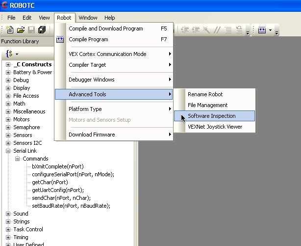

The software inspection menu can be found here.
[ATTACH]7405[/ATTACH]
and should look like this (if you have ROBOTC V3.60 which I recommend).
