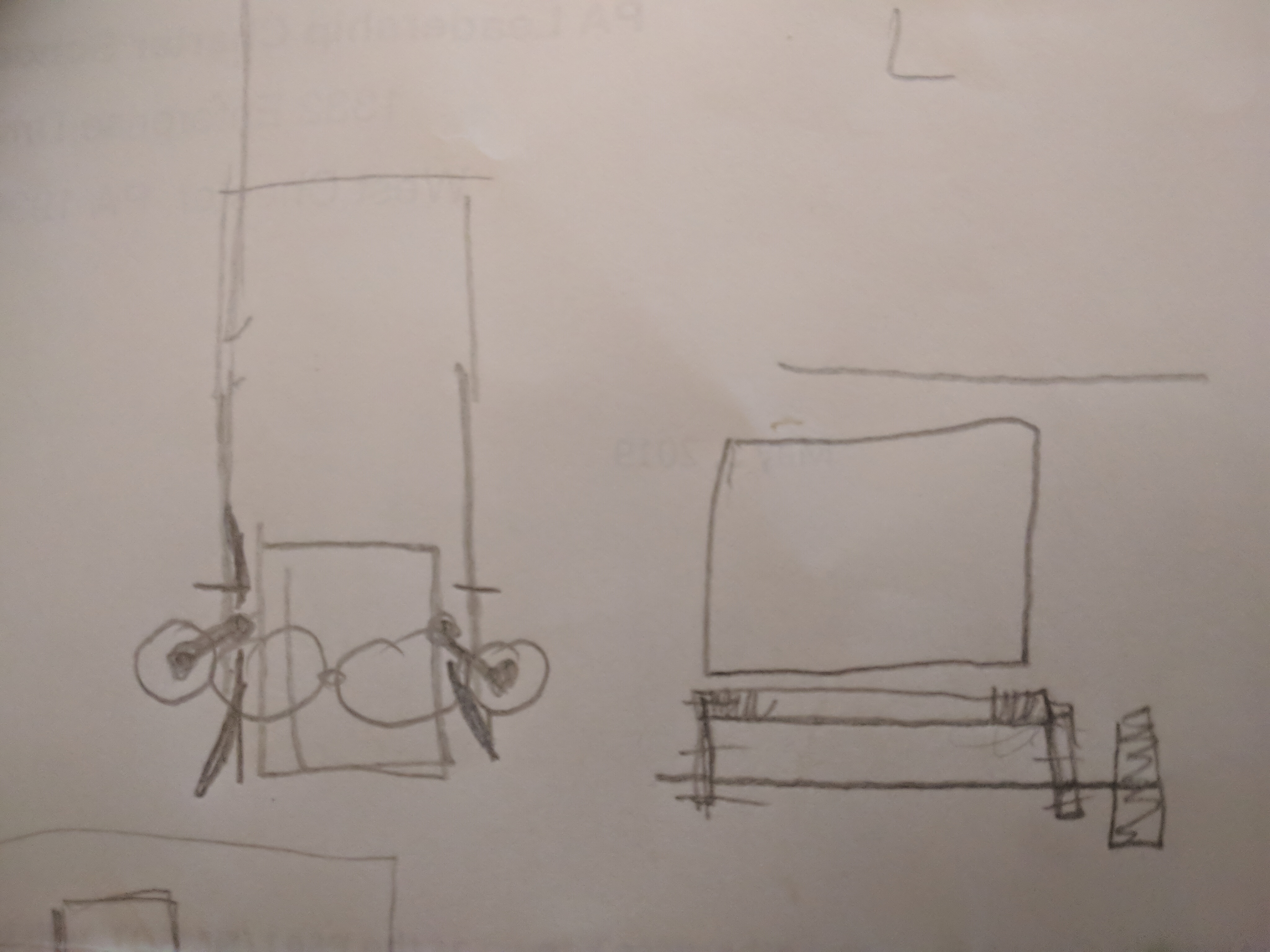

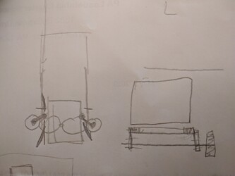

I am however working on another design which could be much more viable. This new design will have a completely rigid cube hold and do internal stacking. The design will include a completely passive intake that even holds cube with more force the more cubes there are. Here is quick sketch of the design…
A new video will come out showing exactly how this new design will work.

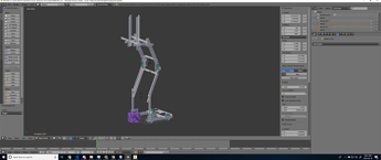

Working on the new robot animation…

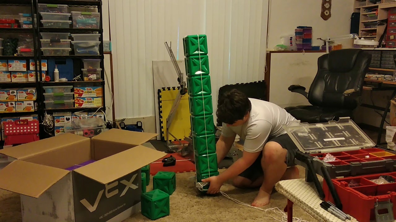

Well, the video is only a video made with editing software. It might only be large enough for 4 to 5 cubes, but if you have enough string, It’s fine.
My team has begun to build the robot. The string is not easily ripped or cut.
