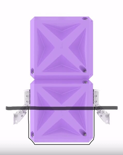

completely friction based. This looks promising.
How many cubes do think you can stack before the intake will give in and a cube will slip out?
Since each cube stacked puts more weight on the bottom one, the intake has more strength the more cubes there are. Therefore, in theory, this will never happen.
Great design! My only suggestion is that you might want to decrease the length of the cube holders in order to descore cubes in the tower. I had that problem with my passive intake system previously.

That’s assuming the force is a 1:1 ratio. If what you said is true then there would be no need for the mesh, but obviously the cube would fall with just a few more on top of it if there was no mesh. It is very possible that the amount of cubes before the friction lock breaks is beyond what the linear sliders can fit, but I don’t know how you would figure it out other than testing it.

Can anyone shed some light on how the stack of cubes is rotating from the center out to place the cubes down. I know the release has not yet been designed. Just wondering how the stack pivots out.
I believe There is a small four bar that moves the stack outward from the center of the robot.
I see the 4 bar that moves, just can not figure out the motor gearing to make it move like that.
