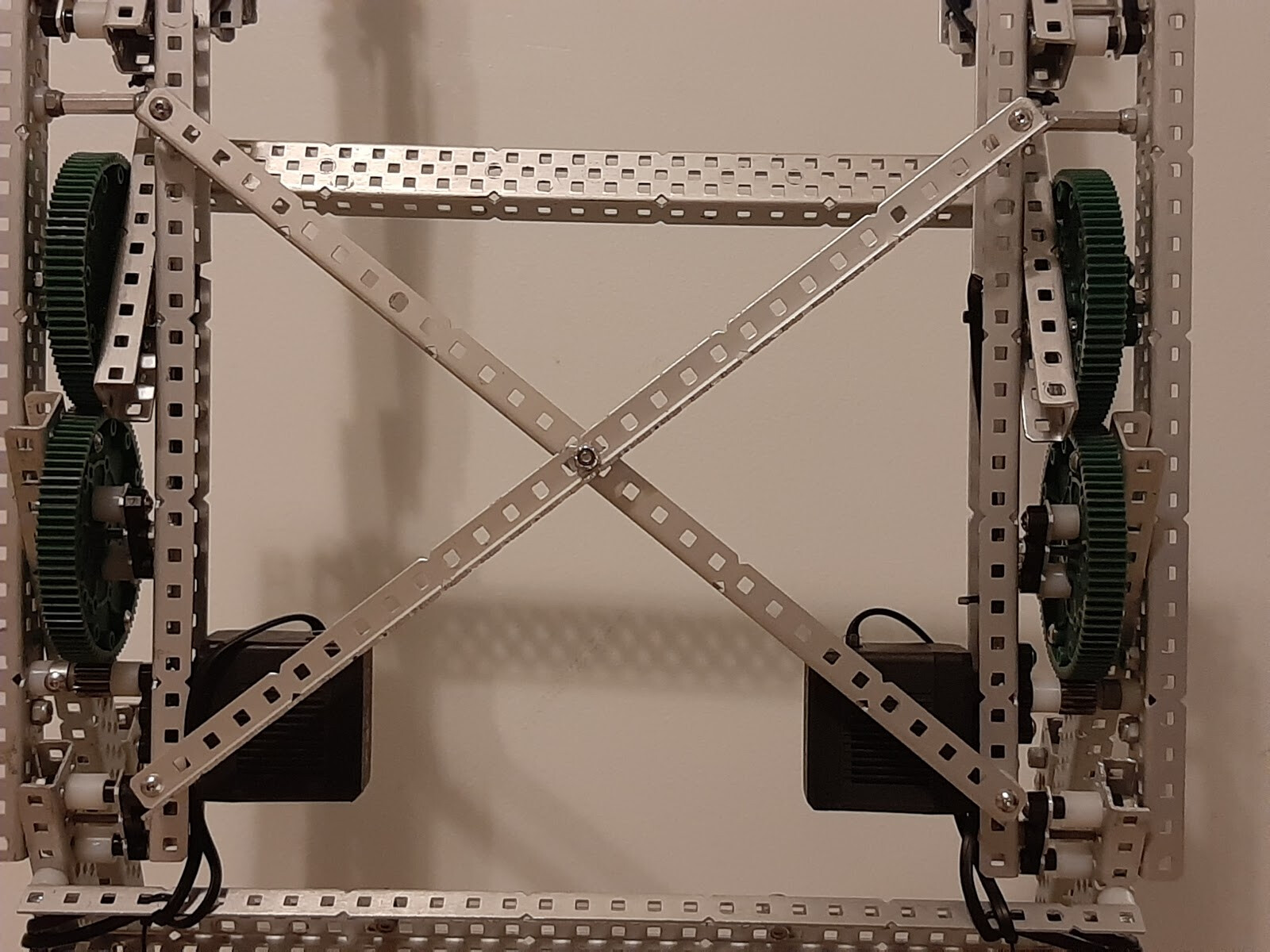

does anybody have any tips on how I can improve the lilt joints to reduce wobble ,and yes I have watched the kepler electronics vid
on the dr4b, there is a rectangle where your gears are. If you put 2 half c channels across(corner to corner) the structure is much stronger.
