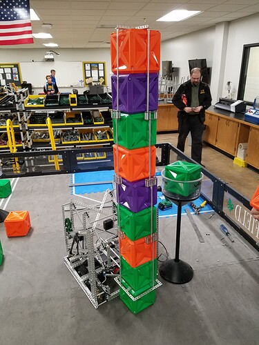

My team and I are building a dr4b and we are having trouble with it lifting the arms, I think its because of a weight problem and the rubber bands aren’t helping any. I found out how to calculate the Nm (Newton meter) into foot pounds and i ended up with 7.7 foot pounds, but its only lifting about 3 in of the base of the robot and won’t lift all the way without help.
Ours looks similar to this
How many motors are you guys using? Also, what is the gear ratio on the lift?

5:1 or 60:T12T
20 characters
Okay. I think that a 1:7 torque (12:84) would be better.
yeah i was planning on changing it but i realized that is would take a lot of time to do that to just replace 4 gears
