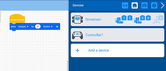

There are numerous Drivetrains being used by teams in the forums so it’s not likely to be a software issue if you are using the generic blocks drivetrain (example below).
