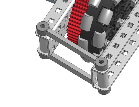

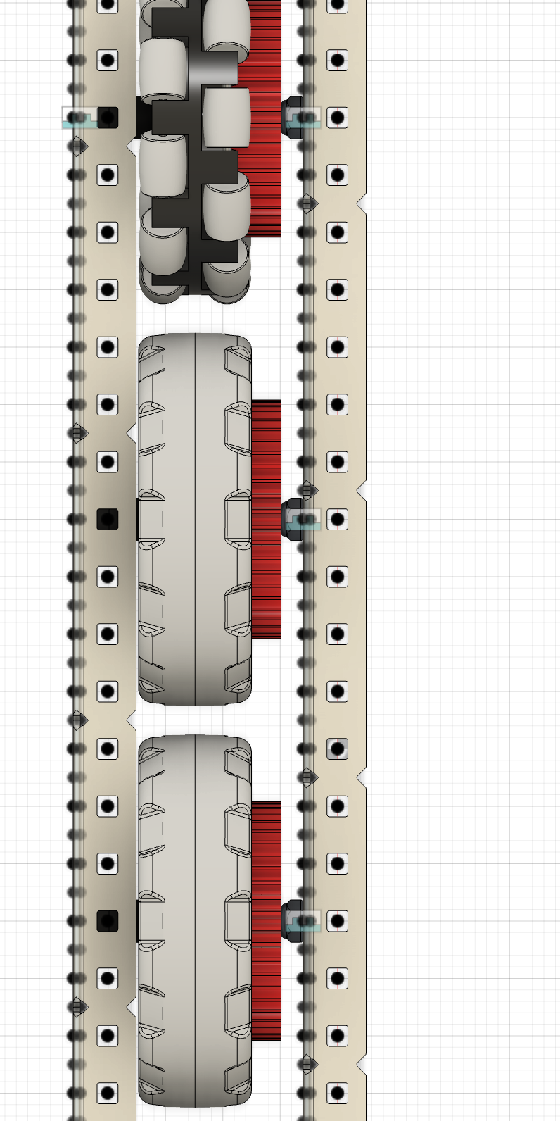

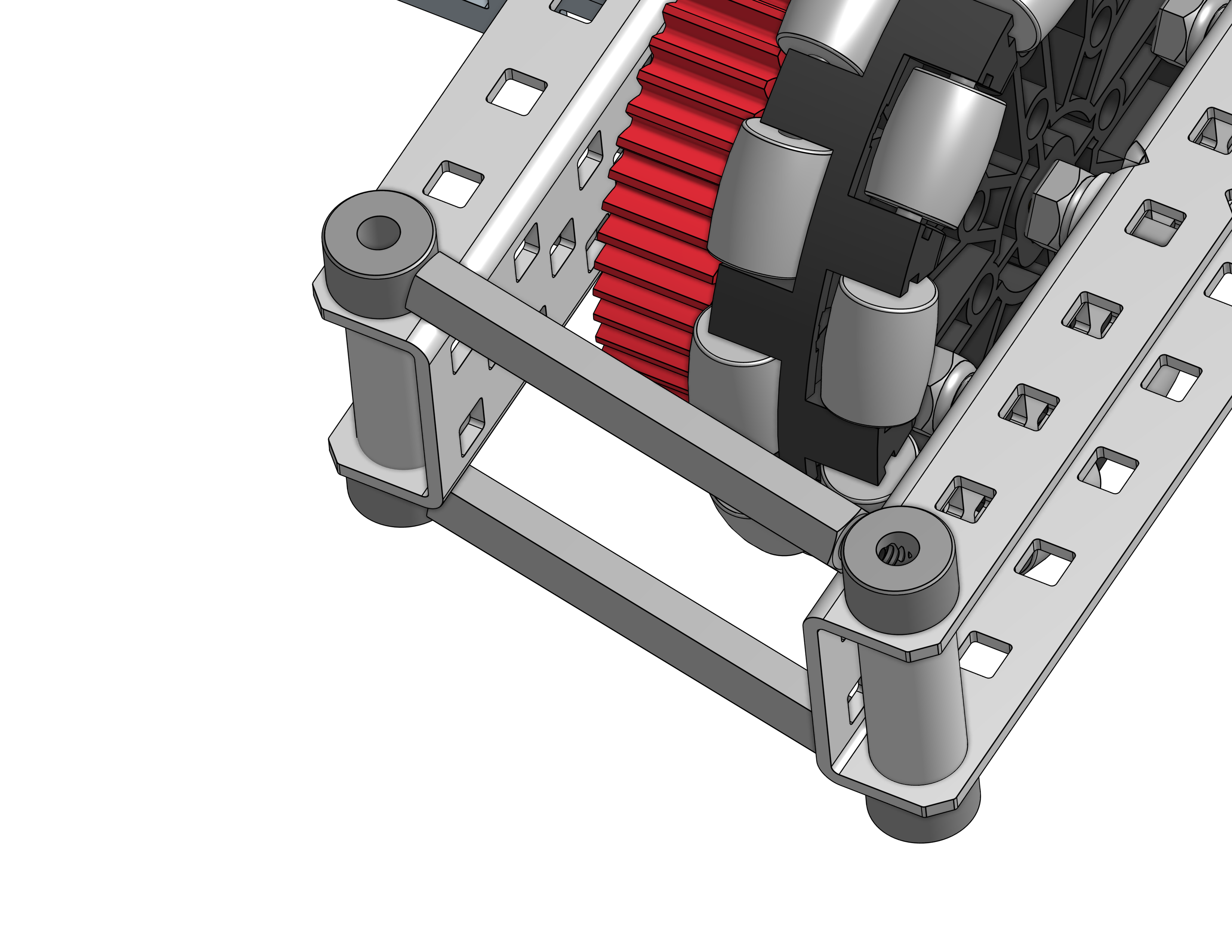

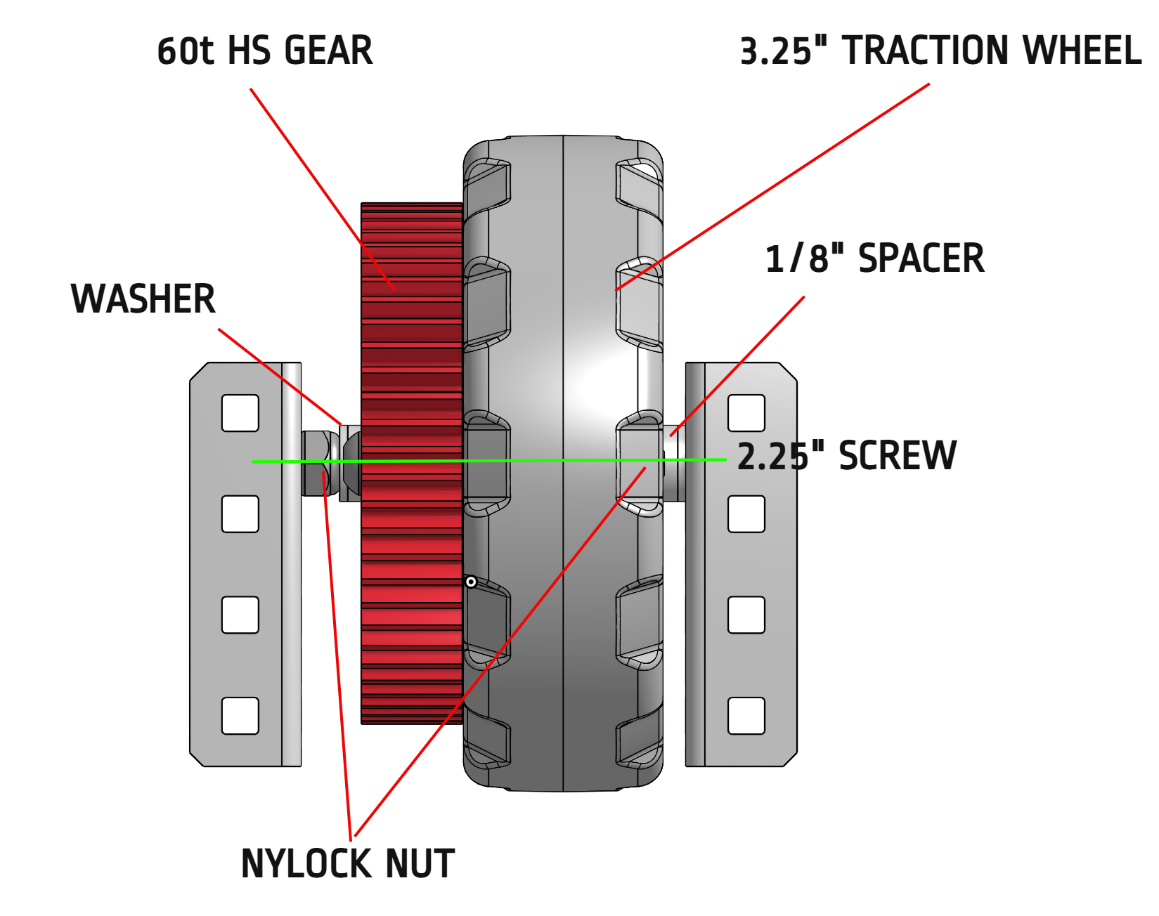

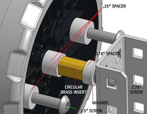

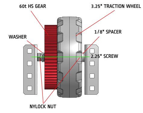

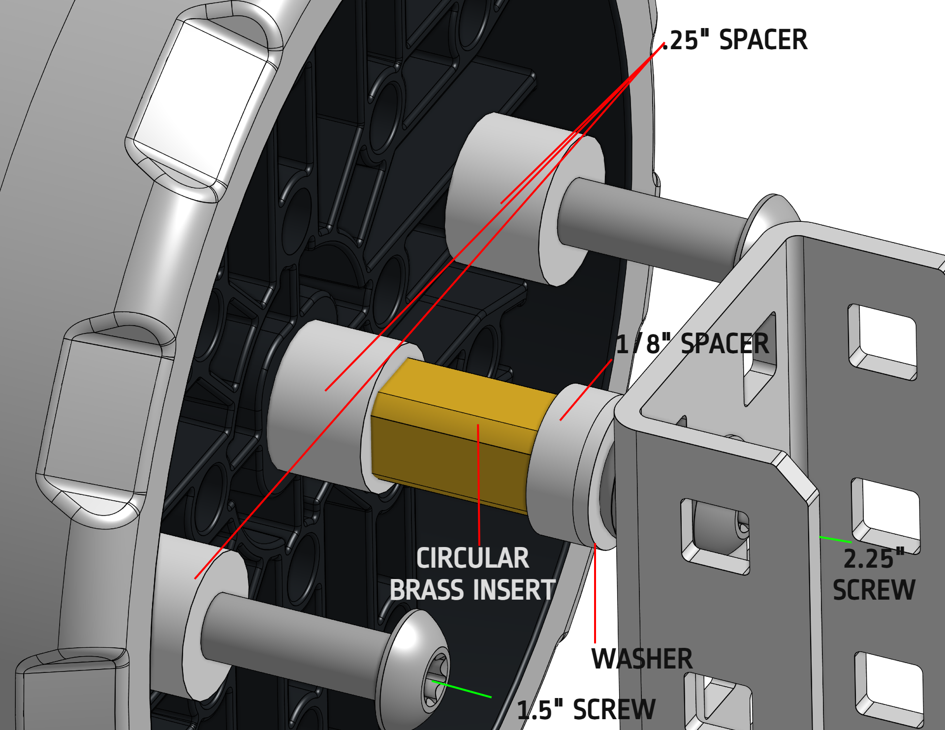

Here is a design that I developed for my team’s drive. Granted, this could be completely wrong and not a viable design (I mean I really am new to them), but I designed it using knowledge from others. (also sorry that the text is hard to see if you’re using dark mode like me–this was made for a lighter background)
Side view
Gear Hidden to show insides
Measurements
(Please do your own designing, this is just an example)
Note that this is a 4 hole wide drive which is not necessarily the most advanced, but I frankly didn’t trust myself making a 3, lol.
I used …
  • Nylock nuts (these are typically recommended for screw joints if you didn’t know)
  • Spacers to ensure that the joint was rigid and had even less wiggle room
  • A standard format for all the axles to ensure that the gears and wheels align as close as possible
Now, time to talk about the drive sandwich caps…
While I have nothing against using the C-channel, it can be rather bulky and hard to screw to the drive sandwich. Perhaps you should consider using standoffs and shaft collars instead (You will need a coupler to connect them when you build them).

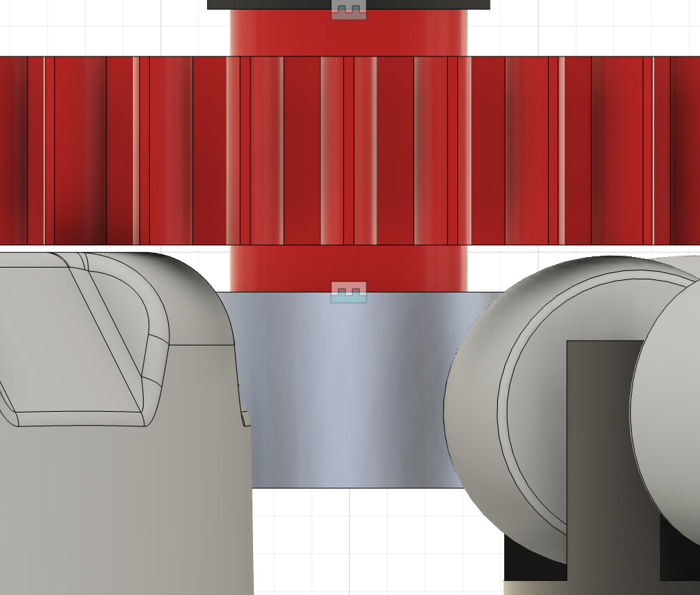

Hey, first of all thank you for your lengthy reply. I ran into another issue while cading. The shaft collar doesn’t really fit. I’ve read some other forum posts, they used rubber band and zipties. Is this a viable option or should I drop this design?

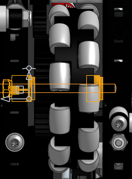

One key issue I notice is that the nut for your screw is in the wrong place, what you want to do instead is to put the nut directly on the opposite side of your screw on the other side of the c channel. this way it will free up some space and allow for that nice sweet five hole wide drivetrain.
ahh yes I have ran into the same issue before. you can buy the custom spacers on robosource that are thin enough to fit in between. you can just run these through out the axel.
https://www.robosource.net/search?controller=search&orderby=position&orderway=desc&search_query=spacer&submit_search=
the solution is quite simple. put the screw to where it is screwed from the other side and that other side is the outside of your drivetrain.
This makes it where u can put the lock nut inside the C-channel where it doesn’t stick out and gives u much more wiggle room for the wheel

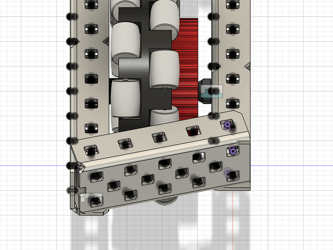

Heres a picture from my teams cad this year
Dont worry about other stuff in image thats just other parts of cad not drivetrain
Hop[e this helps :slightly_smiling_face:
