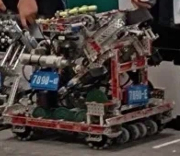

I’m the operator of the 7890E, Double intake is actually not that much easier for me, Because the whole machine is too heavy when it’s finished, I don’t think it’s worth it to trade machine speed for double intake
What caused the extra weight, I think it could’ve built to be pretty light.
