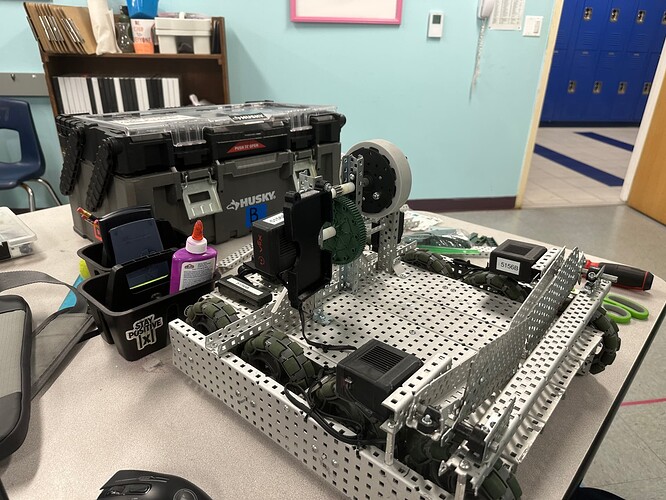

Elevation ideas needed fast!
We are VERY stuck on elevation ideas and have 4 hours of meetings left before our last Comp. to qualify for states. We are at 7/8 full motors, none can be removed and flywheel and wings can’t be moved. We’re also a very heavy bot with all blue drive motors. If you have ANY ideas just let me know (Photos are also helpful(Please))

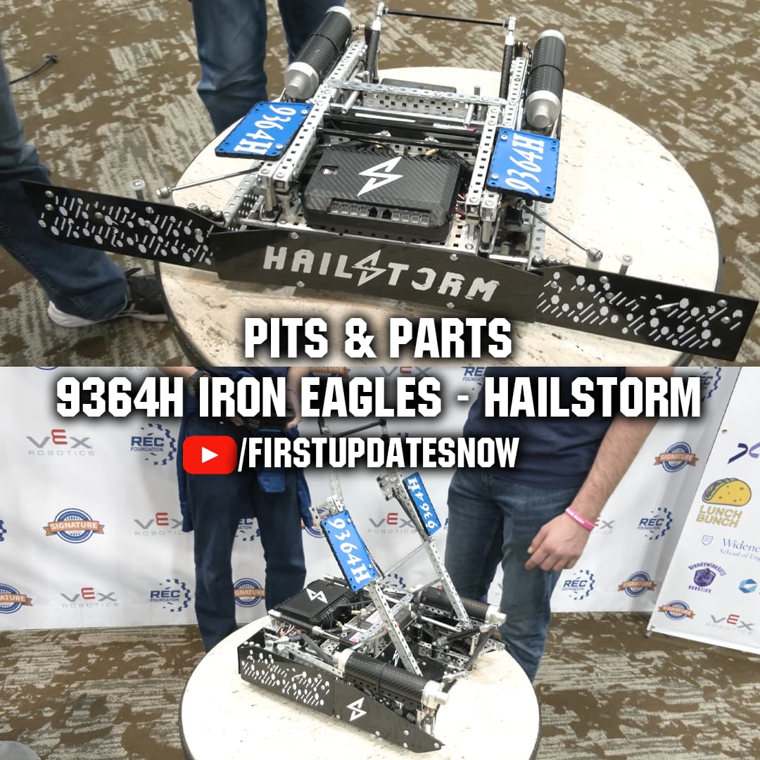

Do a passive hang mech. This involves a pneumatic flip-out that you use to balance on the middle barrier.
Here’s hailstorm’s mech:
(Skip to 4:24)
Also, I would not use all those 1x5x1 c-channels for the bottomof your bot. That is extremely heavy and could easily be remedied with some cross braces.
You could try devising a method to drive up on the horizontal barrier to get the A tier elevation.

I would add a passive side barrier hag to the side for the robot for a simple easy elevation
Thank you so much. This worked for us.
