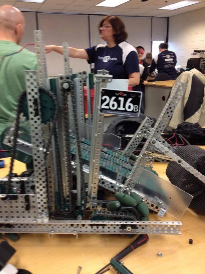

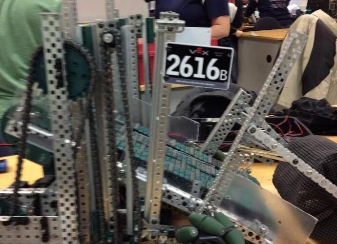

Be very careful with how you build your robot with an elevator…attached is a picture of the first iteration of my teams robot for Sack Attack. We wanted to build it to be a hoarder so it is an extremely powerful lift. However, when we tried to lift around 14 sacks, the green delrins of the linear slides would give out, making our robot useless.
Some things are not cut on the robot because we wanted to make sure we were absolutely happy with the design before cutting metal. The picture was taking at a scrimmage we went to, and we switched to a 6-bar soon after it.
I would never build an elevator with new slides. Old slides are basically a necessity if you want it to be strong.
This is not true. You just have to methodical and careful with your design and build. The weight of using the old sliders, especially for the stages and height required for this year would most likely be counter-productive.
One of the issues I see with the picture shown is that you had an elevator on each side. This allows for the problem of offset extension, often seen with scissor lifts and why so many have issues. While you can have encoders on each side to keep them equal, etc. etc. even if they are offset a very small amount over time or with a large load it can fail as you said.
While I do think it is smart to have two sets of slides per stage for strength and rigidity, I would strongly advise bolting the two sets together so they move together.
While it is not completely similar if you look at effective elevators in FRC (254-2011, 111-2011, etc.) is that everything is bolted together, they don’t have two sides powered separately. This is huge in making the elevator work because otherwise if they’re offset the friction can quickly become way too built up.
Also having two separate sides is just a waste of weight…
