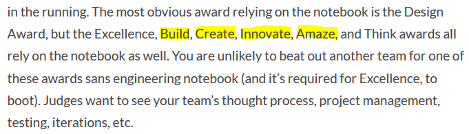

This article may be helpful: https://renegaderobotics.org/engineering-notebook-design-award/

I appreciate the time Renegade Robotics puts in to helpful articles like this one. However, I’m afraid judges or potential judges would be mislead into placing more emphasis on the notebook for awards where the notebook isn’t a requirement spelled out in the judges guide.
Build, Create, Innovate, and Amaze don’t list the notebook as a consideration for the award. For the Create Award teams do need to demonstrate a creative design process, and that could be done in the notebook, but it isn’t a requirement. It’s kind of the same with the Think Award. The programming needs to be well documented, and the notebook is the best place to do that, but it’s probably not exclusive.
I’m not saying the article says the notebook is a REQUIREMENT, but it seems to lean that way. Too many times all these other awards become 2nd, 3rd, and 4th place Excellence Awards. Likewise, too often performance requirements leak into Design Award deliberations.

The way they’re written and described makes it seem like runner ups to excellence.
Like at Worlds this past year, the description for the Innovate Award which one of my teams won basically made it out to be a 2nd place Design Award, because it directly mentioned the notebook.
Amaze for a while my friends and other coaches have come to see as a 2nd place Excellence where a notebook isn’t required.
Understandably, at VEX Worlds the criteria and considerations are somewhat changed from a local tournament or state/regional championship. For example, in past years online challenges played a role in Excellence at Worlds, and of course they didn’t for other tournaments.
