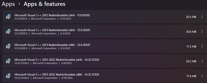

ok, that’s useful and more or less confirms what I suspected. clang (the compiler VEXcode uses) does not run due to missing dll or something like that, most likely it’s missing windows C++ runtime. open up “apps and features” and have a look at what is installed, my windows 10 box has all these but IIRC the important one is the 2015-2019 redistributable.
there are usually two versions, one x86 and one x64, if either is missing you could perhaps try reinstalling from here.
in addition, check in the c:\Windows\System32 and SysWOW64 folders for the vcruntime140.dll file, my guess is that’s the one that’s missing.

My email to vex was responded too and we fixed that error by installing the latest version of Microsoft C++, but now this specific error is back and still persists so I’m glad we’re making headroom!
Here are all my C++ versions as well as the one you have mentioned [UPDATED from original]
Then you asked me to check for the vcruntime140.dll files in the (C:) drive, first was in System32 which is confirmed to exist:
Then in SysWOW64 which also exists after installing the (x86) 2015-2020 C++ Redistributable!
I’m going to completely wipe Vex Robotics from my computer, then perform a restart, and attempt to install and generate a new project, and finally (hopefully) build the project with no changes to it.

OMG! THANK YOU!! IT’S FIXED!! AND ALL THANKS TO YOUR WORK!! THANK YOU!!!
