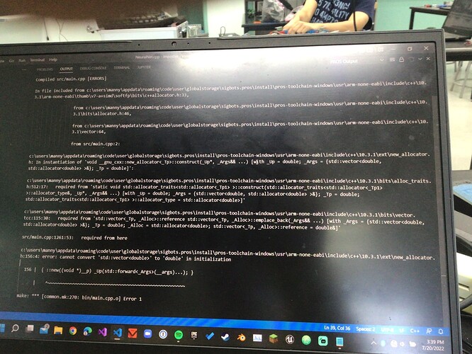

Error in “new_allocator”: cannot convert std::vector<double> to double in initialization
Hey everybody, I’m getting a strange error that doesn’t let me build my project. It’s the error in the title.
This is the full log. I have no clue what’s wrong here, although I do think the error comes from the use of many double vectors in the code. Any ideas what’s going on? Thank you for any help
Please, post your code. You are, probably, use extra parenthesis and passing vector type as an argument to the new operator.

main.cpp.1261
std::vector<std::vector<double>> testInput2DVector;
std::vector<double> testInputVector;
std::vector<std::vector<double>> testOutput2DVector;
for (int i = 0; i > 100; i++) {
			testInputVector[0] = 1;
			testInputVector[1] = 0;
			testOutput2DVector[i][0] = .5f;
			//testInput2DVector[i].emplace_back(testInputVector); where the error
                                // was, though now its line 1330 because i did some editing of my code
however i think the error log has changed even more. (mind you, i did comment out the line where i was passing a vector as a parameter). it was also the only occurence of emplace_back in my code.

The error log still references emplace_back here: c:\users\manny\appdata\roaming\code\user\globalstorage\sigbots.pros\install\pros-toolchain-windows\usr\arm-none-eabi\include\c++\10.3.1\bits\vector.tcc:115:30: required from 'std::vector<_Tp, _Alloc>::reference std::vector<_Tp, _Alloc>::emplace_back(_Args&& ...) [with _Args = {std::vector<double, std::allocator<double> >&}; _Tp = double; _Alloc = std::allocator<double>; std::vector<_Tp, _Alloc>::reference = double&]'
You are misusing vector::emplace_back. A look at some documentation here shows that emplace_back takes an argument list and constructs the element in place. You should consider using push_back which takes an element.
Also
will be trying to put elements into spots on the array that they are not allocated for. You should use vector::push_back until the arrays are the proper size, otherwise i believe you will get a memory permission error.

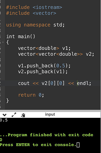

Calling testInputVector[i] returns the underlying vector at index i. You cannot emplace a vector behind a vector, which is why there were an error. You’ll want to use push_back or reserve(1) + emplace_back on the 2D vector object in order to append the vector. Changing the code slightly seemed to compile and run fine for me.
Also, how you’re interacting with the vectors is also problematic. In the code, you used the operator to directly assign value to the vector. However, unlike arrays that have a set size defined, vectors are defaulted to be constructed with a size of zero. Therefore, within your code, index 0 does not exist, and calling it will result in an undefined behavior. (as shown in the photo below, nothing is printed due to an undefined behavior). You will want to either use push_back or reserve + emplace_back to increase the size of the vector.
Overall, it seems like most of the compile errors stemmed from misunderstandings of how vectors are used. I’ll strongly recommend you to watch some tutorials / read the api to have a better understanding on how vectors are used correctly.
