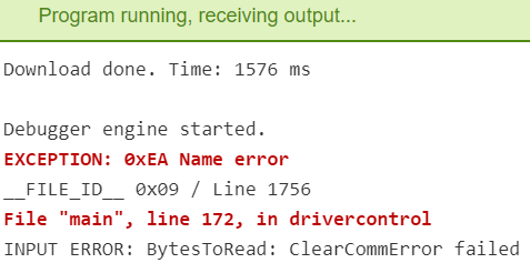

I am getting the error:
Program running, receiving output...
Adding image: main
Program size 5 kb.
Compile done. Time: 1289 ms
Listening for output...
Download done. Time: 1576 ms
Debugger engine started.
EXCEPTION: 0xEA Name error
__FILE_ID__ 0x09 / Line 1756
[File "main", line 172, in drivercontrol
](chrome-extension://ablgfcdjafdflgnbbbffcdginlaoembf/project.html?id=1#)INPUT ERROR: BytesToRead: ClearCommError failed
on this line of code:
Tilt.stop(vex.BrakeType.COAST). and when I comment out the line of code, the error moves to the next line of code.
Our full code

You’re referencing the Tilt motor but you commented its declaration out by hand in the automatic config region. The error moves to the next like because the next line also references the Tilt motor that doesn’t exist.
Thank you so much :slight_smile:
