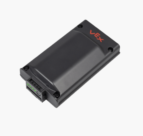

Does someone have an image of which EXP batteries are being referenced? We are looking for some alternatives for practice batteries, so seeing which EXP batteries “fit” in IQ.
There is only one EXP battery and it looks like this:
Screen Shot 2022-04-08 at 10.34.36 AM
Shape-wise, it’s an IQ battery wearing a backpack.
EXP batteries are currently only available as part of the EXP Education kit, they are the same physical size as IQ Generation 2 batteries, but have a different specification due to the higher power demands of EXP. They are a slightly different color and silk screened text is red rather than blue.
It’s the same shape as an IQ gen 2 battery, as far as I can tell.
So they are slightly different internally, but the original question remains! If I took an EXP battery and put it in a second gen IQ brain, would it work?
Yes, it works, I thought we established that. But it’s most likely not competition legal.
The part numbers are different
IQ Generation 2 battery, 228-7045, 14.4 Wh
EXP battery, 280-7126, 18 Wh

The gen 2 batteries, being Li-Ion, have a flatter discharge curve, in other words, they will maintain voltage above the minimum needed for good motor performance for longer.
Both EXP and IQ generation 2 batteries have nominal voltage of 7.2V. The EXP battery can handle higher current demands of the 5.5W, EXP/V5 motors.
