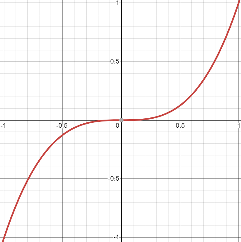

So, I tried googling and searching the forums for this, but I can’t find anything. I am trying to drive my robot as an exponential speed of the controller value. I want my robot the drive at the speed at the controller value^3, so it matches this graph:
This is to give my driver greater control over the robot. How would I do this in RMS python for V5, so it is neater than this:
motor_1.spin(vex.DirectionType.FWD, (con.axis1.position(vex.PercentUnits.PCT) * con.axis1.position(vex.PercentUnits.PCT) * con.axis1.position(vex.PercentUnits.PCT)), vex.VelocityUnits.PCT)

Looking at google, you should be able to use python’s exponent operator, **
Example:
3 ** 3 = 27
so I do: motor_1.spin(vex.DirectionType.FWD, (con.axis1.position(vex.PercentUnits.PCT)**3, vex.VelocityUnits.PCT)?
I believe that is correct.

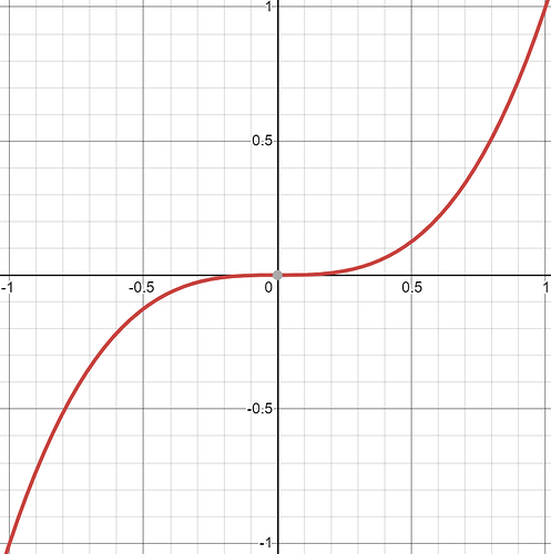

motor_1.spin(vex.DirectionType.FWD, (con.axis1.position(vex.PercentUnits.PCT)**3), vex.VelocityUnits.PCT)?
Be sure to divide the result of position ** 3 by 100 ** 2 or it will go out of the range that spin wants (-100 to 100) by the time you’ve moved the joystick even 5% (5 * 5 * 5 = 125).
So I do motor_1.spin(vex.DirectionType.FWD, (con.axis1.position(vex.PercentUnits.PCT)**3)/100, vex.VelocityUnits.PCT)
Almost there. Keep track of what the maximum values can be: 100 * 100 * 100 / 100 is still 10,000, when you wanted it to be 100 at max. To set up the algebra problem:
100 * 100 * 100 / x = 100
motor_1.spin(vex.DirectionType.FWD, ((con.axis1.position(vex.PercentUnits.PCT)/100)**3)100, vex.VelocityUnits.PCT)?
Needs a * between the ...**3) and the 100,... and it should work
motor_1.spin(vex.DirectionType.FWD, ((con.axis1.position(vex.PercentUnits.PCT)/100)**3)*100, vex.VelocityUnits.PCT) ?
Like that, yep. That should give you a range of -100 to 100 like spin wants for its velocity domain.

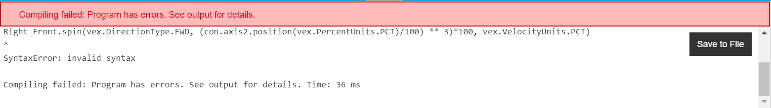

I’ve tried that and it does not seem to work. What is the problem? Thank you in advance.
        Right_Front.spin(vex.DirectionType.FWD, (con.axis2.position(vex.PercentUnits.PCT)/100)**3)*100, vex.VelocityUnits.PCT)
        Left_Front.spin(vex.DirectionType.FWD, (con.axis2.position(vex.PercentUnits.PCT)/100)**3)*100, vex.VelocityUnits.PCT)
        Right_Back.spin(vex.DirectionType.FWD, (con.axis2.position(vex.PercentUnits.PCT)/100)**3)*100, vex.VelocityUnits.PCT)
        Left_Back.spin(vex.DirectionType.FWD, (con.axis2.position(vex.PercentUnits.PCT)/100)**3)*100, vex.VelocityUnits.PCT)

Full debugger output
Compiling failed: Program has errors. See output for details.
Downloading vm/library.
Adding image: main
Traceback (most recent call last):
[File "main", line 160
](chrome-extension://ablgfcdjafdflgnbbbffcdginlaoembf/project.html?id=1#)Right_Front.spin(vex.DirectionType.FWD, (con.axis2.position(vex.PercentUnits.PCT)/100) ** 3)*100, vex.VelocityUnits.PCT)
SyntaxError: invalid syntax
Compiling failed: Program has errors. See output for details. Time: 36 ms
You have more closing parentheses than opening parentheses on each of those four lines
    Right_Front.spin(vex.DirectionType.FWD, ((con.axis2.position(vex.PercentUnits.PCT)/100)**3)*100, vex.VelocityUnits.PCT)
    Left_Front.spin(vex.DirectionType.FWD, ((con.axis2.position(vex.PercentUnits.PCT)/100)**3)*100, vex.VelocityUnits.PCT)
    Right_Back.spin(vex.DirectionType.FWD, ((con.axis2.position(vex.PercentUnits.PCT)/100)**3)*100, vex.VelocityUnits.PCT)
    Left_Back.spin(vex.DirectionType.FWD, ((con.axis2.position(vex.PercentUnits.PCT)/100)**3)*100, vex.VelocityUnits.PCT)
Thank you so much!! (looks like I can’t copy and past)
