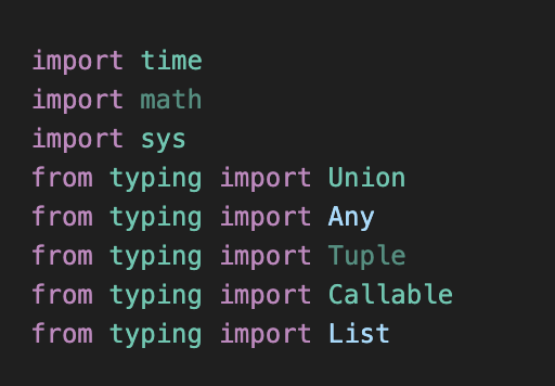

These are the built-in libraries you can access: (time, math, system, typing)
Screenshot 2024-06-11 at 1.01.31 PM
There are some ways to get other small libraries shown here: How do I download modules to the brain?
full list of frozen libraries (micropython libraries from version 1.13)
