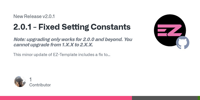

It was an issue with EZ-Template. This has now been fixed in version 2.0.1, and the example project has been updated to 1.1.0.
Let me know how it goes!
Yay Thanks for the update
Just to clarify, was it not driving accurately an issue with the template? Or was the issue the PID values not changing?
