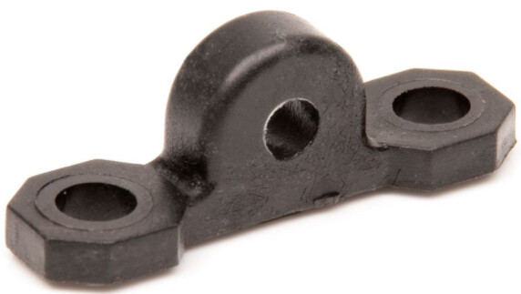

  • oh and seeing that you are new to vex equipment, you ALWAYS use bearings with axles. ALWAYS.
    These are bearings:
    image image image
    If there is only one thing that you take away from this post, make it be:
ALWAYS use bearings.
