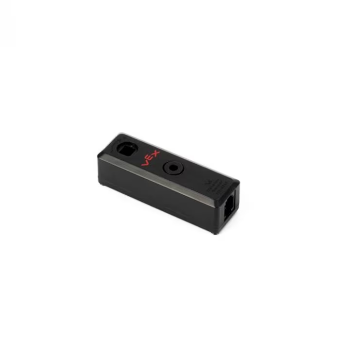

We used the V5 vex rotation plugged in the flywheel shaft to measure the current velocity of the flywheel.
The native input of the rotation sensor using pros is in centidegrees per second. But, we wanted to transform the units to one that would be more useful for use and more practice to us , so we transform to RPM (Revolutions per minute).

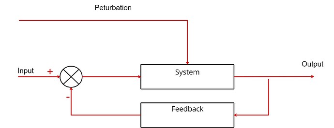

At the first iteration of making the controller for the flywheel we used a feedback controller such a P controller.
float target_Rpm = 2000;
float kp = 3.1;
while (1) {
float current = Rotation.get_velocity();
float error = target_Rpm - current;
float proportional  = error * kp ;
Flywheel move (proportional)
We used a PID controller for our flywheel and worked just well, however we found that tunning this kind of controller was difficult and hard for us, so we had to use another controller.

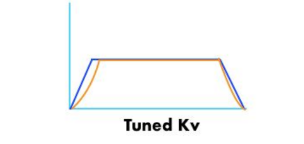

  1. Ks, start adding some portion of voltage to your system (flywheel motors), tha portion of voltage that makes that your system start to move would be the value of Ks. For example, using pros you could add 1000 mv to your motors ( Flywheel.move_voltage(1000)). If the flywheel doesnt move you should add more voltage, then if you put 2000 mv and the flywheel start to move that is the correct value for Ks.
  2. Kv, For this variable i recommend to use excel or another tools to plotting and have visual representation of the current and target velocity (You can run your pros terminal in an Excel sheet using the next command, “pros terminal > [name of the archieve].csv” ). Start to picking a low value and run your function. You would to increase this variable until your current velocity star to aproach to some target velocity overt the time.
  3. Ka, Once that we tunned the Ka and Kv, is time to tune Ka. We need to increase to variable until the target and measured velocities match decently.

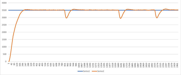

For our controller we use a PID controller for the feedback controller and we have an incredible results. In the next chart we can see how the system reach the target velocity. Each disturbance in the velocity is because the robot just throw a disc. So the velocity of the flywheel decrease and start to inject more voltage to reach the target again.
The time of recuperation for our system was 1 second with 500 miliseconds.
