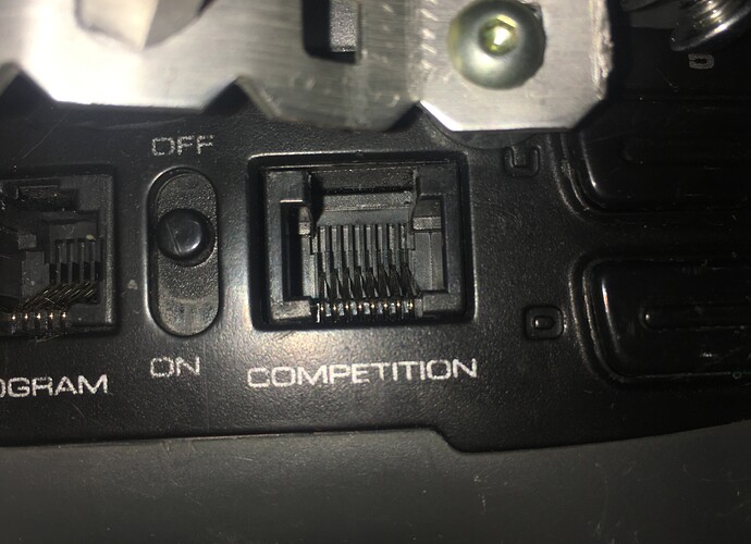

The cases of simultaneous alliance (one alliance) disables I have witnessed have all been related to a bent pin, or foreign metallic debris in the controller competition port. again, I am not saying there couldn’t be other causes, just not ones I have seen.

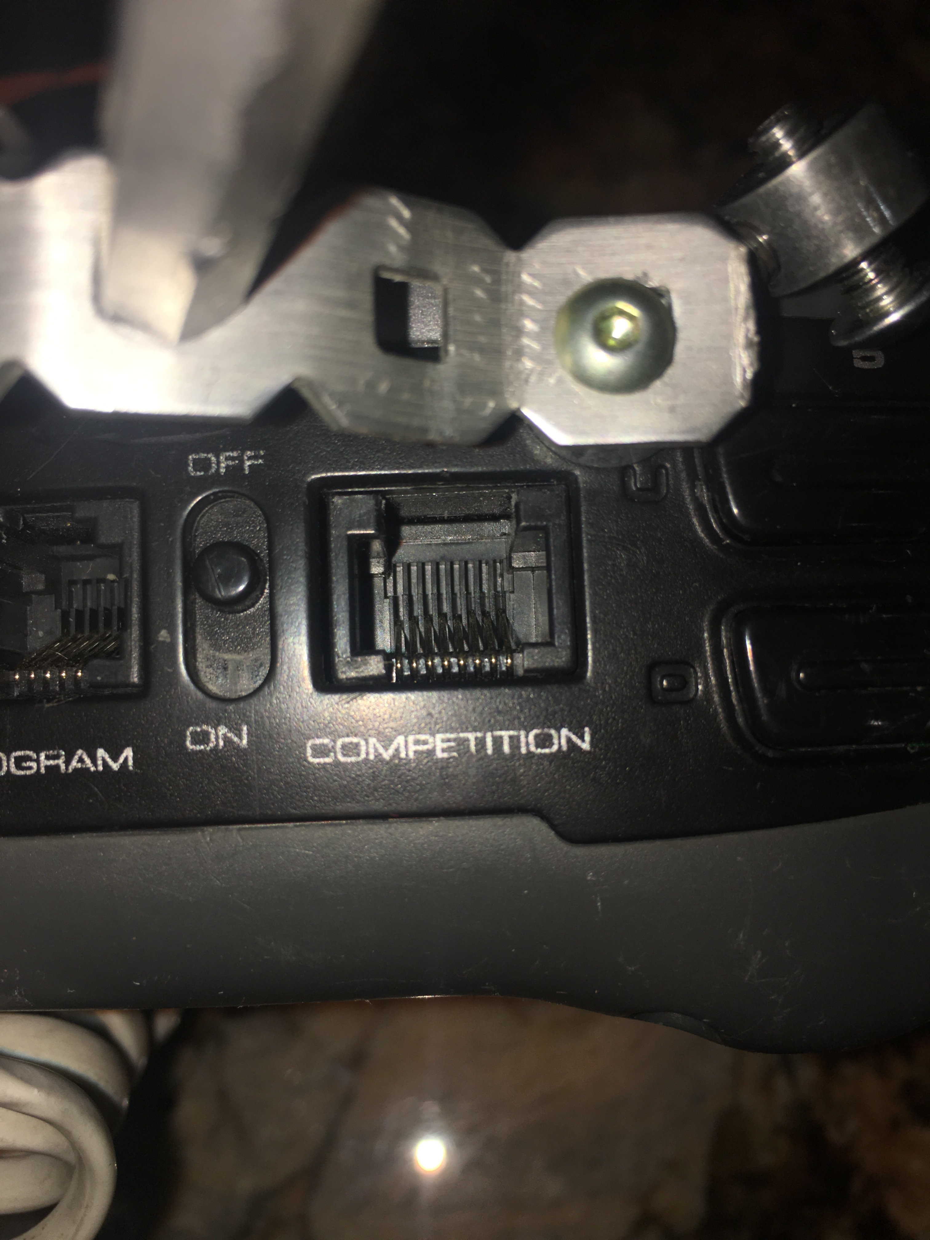

First, thank you for your response. It is really helpful to know you are listening to our feedback and are trying to determine the cause of the issues.
Here is a picture of my controller. There is no damage that I can see besides the absence of the tab that holds the cable in (a task that my partner controller mount incidentally fulfills).
Of course this doesn’t rule out my partner’s joystick being damaged. However I would think that shoring pins in the joystick would cause constant rebooting or other issues, and not the once in a match issues we are seeing.

By controller do you mean joystick? If so, yes, a shorted pin in the competition port on a joystick can disable both robots and change the driver station to yellow (though the yellow light will be solid rather than slowly blinking).
