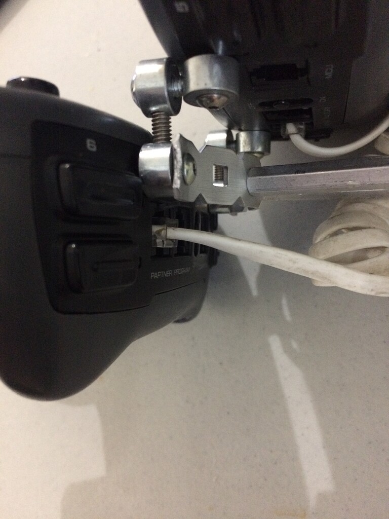

You seem to have an unusual controller setup, do you have the partner controller mounted on the primary controller or is that just 3d printed paddles I can see?
It’s the partner joystick.
I posted pictures in this thread:
There’s no electrical modifications so I don’t see how it could cause problems.
