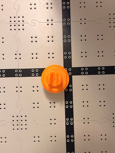

I wanted to get some guidance on a situation our team experienced during a VEX IQ Mix & Match autonomous (Skills) run in states.
At the start of the run, the field pins appeared to be noticeably misaligned ( Picture attached.) compared to the official VEX Robotics field reset diagrams (specifically the Mix & Match Skills Field Reset guide).
The team members requested the judge to adjust the pin to what they believed was the correct position.
However, the judge overseeing the field stated that the setup was already correct and instructed the team not to touch anything. The instruction was delivered quite firmly, which made the students uncomfortable. They ultimately proceeded with the run as-is . Fortunately, the program still worked. Thank God!!
As we all know, autonomous routines depend heavily on consistent field setup and coordinates/moves. While some tolerance can be handled in code, larger deviations can impact results significantly and sometime could ruin the whole run.

Are you talking about the rotation of the pins? Can you describe how they were misaligned?
If you think the field is messed up, the students need to tell the head referee before the match starts. According to the rules, the allowed tolerance for pins is plus or minus 0.5 inches. Students have to be the ones to handle it and should stay in the driver station to talk it out calmly. Coaches and other adults aren’t allowed to get involved in these conversations with the referee. It’s best to just ask for the head referee if the person at the field won’t help, since they have the final say on the rules.

Screenshot 2026-03-23 9.04.48 AM
Thanks, I was not aware of the .5-inch tolerance, and it make sense. The code should be able to tolerate that. But in this case, it was way off.
Thanks for your reply. I forgot to attach the picture. My bad
The pin was placed more or less what it is in the pic or worse than what is shown in the pic as per the team
This is WAYY off! :scream: :scream:
Thanks Much. Yes, I meant referee/adult volunteer, who looked like a high school kid in this case. I agree that lot of referees/volunteers are not clear about the rules, and it is not expected to be perfect world. But the sad part is when referees/volunteers refuse to listen or take a moment to think before they push back the kids. Well, kids have to deal with it at the end of the day. I think it is best to loop back then and still have concerns, the kids to defer to the head ref. Thanks again for sharing your experience.
Thanks much for the clarification. I understand the 0.5-inch tolerance and agree that teams should design their code to handle reasonable variation.
However, in situations where an element appears to be significantly outside that tolerance—like in the example I shared—it would be helpful if referees were open to briefly reviewing the concern or consulting the Head Referee if there is any uncertainty. Even a quick verification can go a long way in ensuring consistency and fairness.
