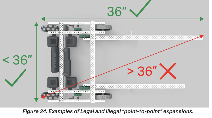

It was more of the pictures and the notes for two teams. They were good on the front to back, it’s the diagonal that is the issue, and actually its the lower left back corner to the upper right when the arm is extended,

sigh - yes, it appears that it is 36" diagonal measurement. Which would be easier to say in a circle.
Why are they so inconsistent? The 18x18x18 isn’t diagonal … but the 36 is?
So, the picture, in my opinion does more harm than good. How can this expansion be both legal and illegal?
Those aren’t the same thing. An object that fits within a 36" diagonal measurement will not necessarily fit within a 36" circle.
I agree that the wording in the caption is confusing. The picture illustrates a robot that is illegal. Even though the width and height are within 36", the diagonal is not, so it is not legal expansion.
They are different specifications. One is for starting size, one is for expansion size.
Good point. Small differences, but it would be easier to understand. IMO
Right, to be clear, it should just say that “This is an illegal expansion”
Understand, but again it’d be easier to be consistent on how to measure your robot.

Just to be clear, when you say “upper” and “lower”, you are not referring to vertical directions, correct? The rule only stipulates the limits of robot expansion in the horizontal dimensions.
This I agree with. By the caption, the diagram is showing both legal and illegal expansions of the robot. The arm in the upper right corner is labeled as legal with a green check in the top of the image, but at the same time is labeled as illegal with the horizontal line. This is very confusing. This diagram needs to be broken into two separate diagrams, one showing a legal configuration and one showing an illegal configuration. Additionally, dimensions should be marked out with neutral black text instead of green, and the legal/illegal condition should be marked with a colored line and symbol. @Jon_Jack do you think there’s any chance the GDC could clarify this diagram in the manual to reduce confusion?
I think it means that size is measured parallel to the direction of expansion. So expanding in a diagonal direction would result in the robot being measured fiagonally
@sazrocks OK, the more I think about it … I agree with everything you said. I’m probably just reaching for ways to make it clearer and it comes down to the diagram that is in the manual that is the confusing part. It should be as simple as showing a picture of a robot that is legal and one that is illegal (instead of trying to combine them into one.

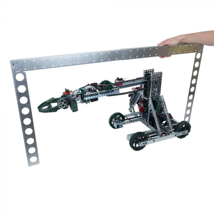

Use the sizing tool.
The furthest two points on a projected horizontal plane have to be <= 36". Thus the 36" sizing tool should be used to measure the robot, holding the tool perpendicular to the floor, but at any angle parallel to the floor.
An 18 x 18 inch robot should have about 13 inches of additional length (18 x 31) if the extended corners are the furthest points.
No, there is NO measuring diagonally. If you look at the robot from straight over head and project the robot onto the plane of the flat surface it is sitting on, there should not be two points that are more than 36" apart. Any sizing measurement for the 36" limit is done parallel to the surface that the robot rests on.
By upper / lower I was looking down from the air to the floor as a picture and was lower left to upper right as a direction.

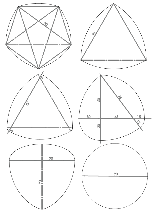

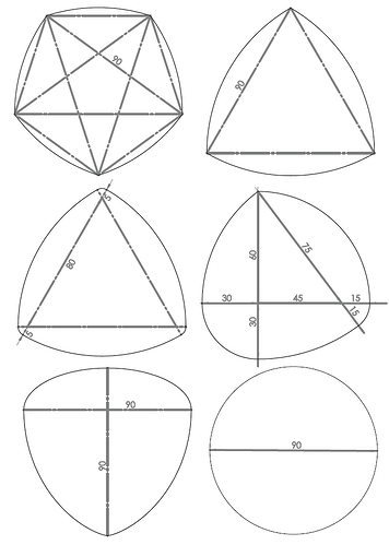

For those who are still confused about it not being a circle, here’s a group of shapes that all satisfy the 36" limit rule while not fitting within a 36" circle. These are all known as shapes of constant width.
(Image source: https://www.rad-head.com/single-post/2018/04/01/Making-Shapes-of-Constant-Width)
Would it be fair to say that a 36” point-to-point inspection analysis is being used? Meaning any point on your robot must not be greater than 36” from any other point on your robot? This is how I understand this rule.
