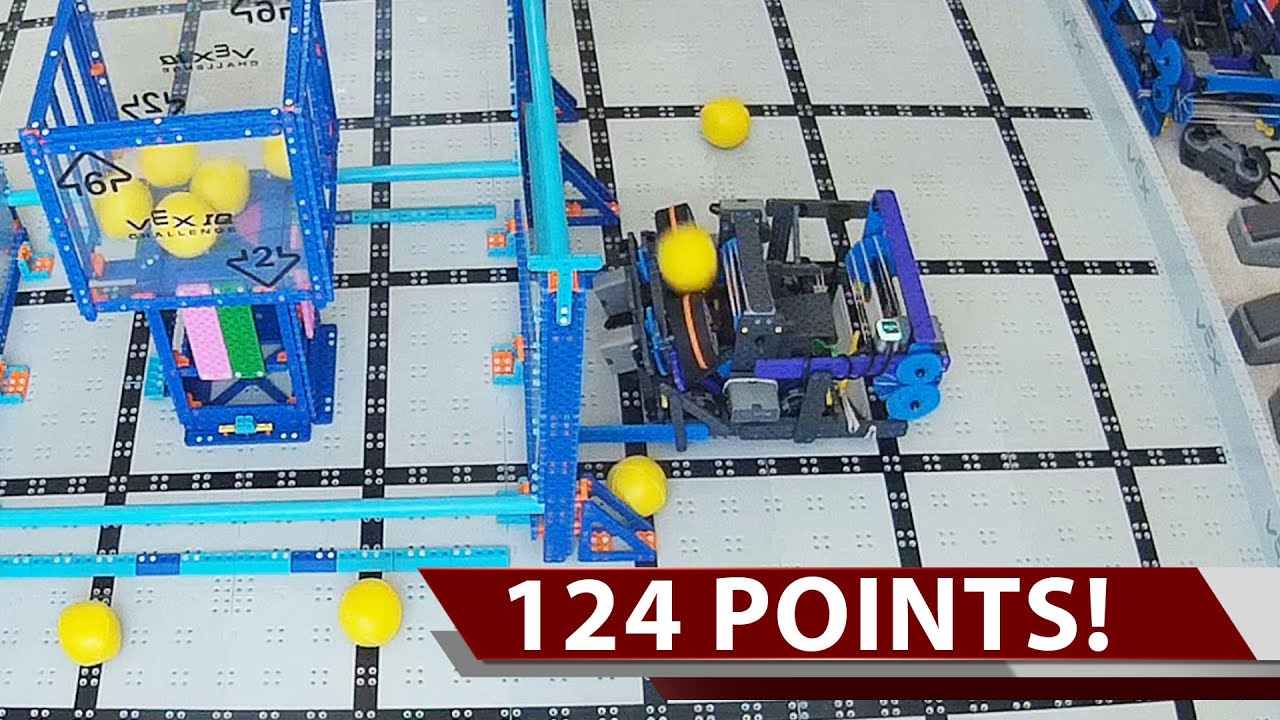

My team’s flywheel struggles to get the ball over the high bar and into the goal. Yesterday, when we finished making the flywheel, it was easily able to clear the bar. However, 20 minutes into testing on the day we finished building it, one of the motors got very hot and the flywheel slowed down. We replaced the motor, and it started doing fine again. Today, we adjusted the angle of our flywheel to try to replicate the strategy used in this video where the flywheel is at an almost vertical angle and the bot runs into the wall:
When we tried it, the flywheel gradually got slower the longer we tested. We put in fully charged batteries, and it didn’t change anything. We put the flywheel back at its original angle and it was sitll not shooting far. After waiting an hour and coming back, the results were the same. Do we need to change the motors constantly for the flywheel to work, or is there another solution? We might need to get new batteries, we’ve had the same few for a while. We have the same 1:15 gear ratio for the flywheel as @FRC973. Did you guys also have to change out motors frequently?

From my experience with Turning Point in vrc, you’re probably overloading your motors. The motors only have so much torque and friction or the load might be too much for the motor to handle. The longer you overload the motors, the slower it gets. This would explain why your motors are slowing down. Long usage of a motor might result in the motor breaking. You can try to fix this by reducing friction in some way or reducing the gear ratio and adjusting the angle.

Generally, the motors won’t damage themselves. Just don’t use them for a while. I do have a number of groups that are using the same gearing and not having those issues. What speed are you running them at? I have one group with a very efficient setup and they only need to run their motors at about 60%.
You really need to make sure that the flywheel gears are running as smoothly as possible. Make sure that only washers are next to the beams, etc… Also the teams use a flywheel weight and the seem to like them. It takes a little bit longer for them to spin up but they seem to have better results.
No, I never changed out the motors. I did have to take breaks from practicing after about 30-45 minutes because the motors would get hot though. In my experience, the flywheel will slow down because of wither a low battery, hot motors, or both. While testing, one thing that can help is not spinning the motors up an excessive number of times. Another thing that is essential is to put your motors on coast, because it is bad for them when you try to bring them to a full stop from spinning at full speed.

What are some things you guys did to reduce friction? We haven’t done anything except put the very thing washers between each gear and the beams.
The other main thing that we did besides putting washers in was to make the gearbox super rigid. This allows for very little play, and consequently very little friction. One key way we did this was by supporting the gears on both sides everywhere, so it was literally a box. We did this to the point where you had to take it apart to see the details of how it worked because there were so many pieces. One last thing that is kind of a given is to not use plastic shafts.
This is one factor that is important, but be careful of build quality! You can build something super rigid, and yet still cause the structure not to line up properly for your shafts to spin freely. You can easily test this by decoupling the shaft from the motor and spinning the mechanism by hand, it should spin freely for a relatively long time. A definite sign of friction foe, is you spin it, and it stops quickly.
In addition to the above suggestions - make sure your shaft is not bent, there is not too much compression between the structure encasing your mechanism making your washers behave like brake pads on car. Look at every interaction between each component and see if it is mechanically interacting with your fly wheel.
