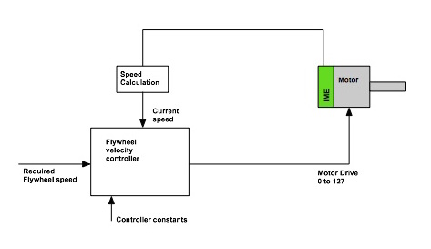

To start with lets look at a diagram of the system we are trying to implement.
There are one or more motors that are connected to the flywheel. I’m not showing the mechanical components here, for the sake of this discussion it doesn’t matter how many motors there are but the assumption is that they are all mechanically connected together and work as one big power source.
There is a means of measuring how fast the motor is turning. We don’t have much choice for the means of doing this on a VEX competition robot, I prefer to use an IME, a quad encoder could also be used.
The flywheel velocity controller is a software algorithm that compares the measured speed of the flywheel to a target speed and makes adjustment to the motor control to minimize the difference between these two.
