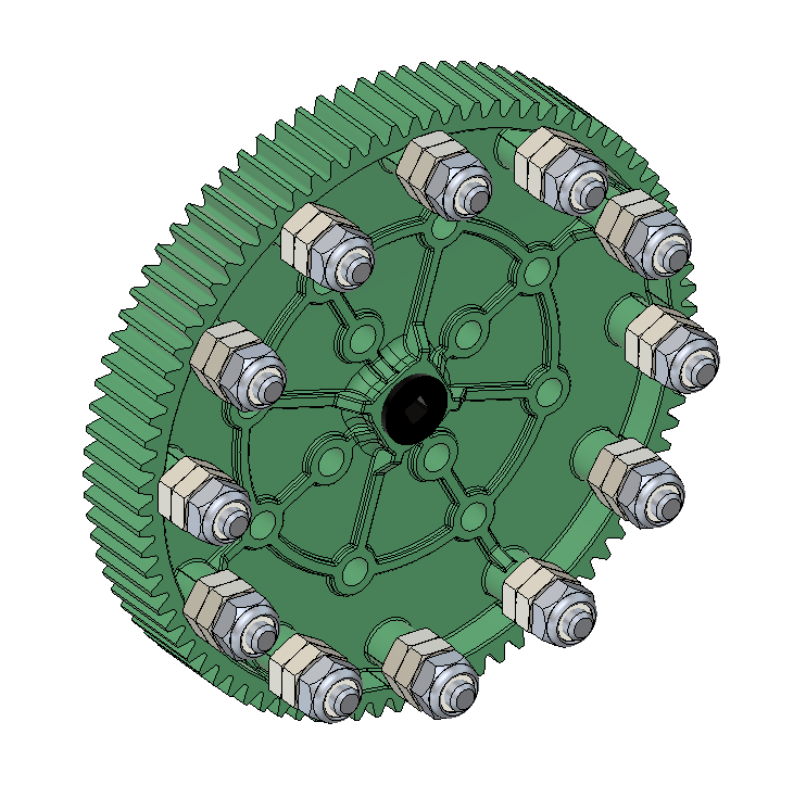

Found this flywheel weight from this fourm post talking about flywheel weights in VEX IQ. Was wondering if anyone has experimented with creating a VRC equivalent? Are they even worth pursuing?
I think that for spin up this year most robots would have their flywheels running throughout the match, especially if teams use turrets that autoalign to the net. The low spin up times that light flywheels offer arent as advantageous since a heavier flywheel not only stores more energy but also is more efficient since once its spinning minimal energy is needed to keep it spinning.
Heres what I think a flywheel weight could look like in VRC
Although you could just spin the flywheel faster, there will be an upper limit for how fast you can spin it since the more gears you add the more friction will be generated in spinning the flywheel. Flywheel weights seem like the way to go if you want to save a motor since you could just use one motor and deal with the long spin up time.
What do you guys think? Maybe I’m going insane here idk

 Power is usually given in Watts. So the power of the flywheel is equal to the wattage of the motor that drives it, about 11 watts per motor. What you decide to do with those 11 watts of power is up to you. Changing gear ratios in your motor affects torque and a speed inversely. The combination of which never gives you more power.
So where does weight on the flywheel come in? This deals with another property called inertia, or in layman’s terms the ability to “not respond to changing situations”. Adding weights to the flywheel will make the flywheel more consistent (not more powerful), the consistency being that every time a disc is launched the flywheel will slow down less because of the extra inertia from the weights.
If an advanced team wants to score more bonus points with judges, calculations of inertia with respect to weight location and radius from the center of the flywheel would be impressive to see in your engineering notebook.

Few comments on your post and the pic you quoted
The most efficient use of mass is on the outer part of the rotating item, like the bolts/nuts shown. Mass in the center has proportionally less effect with inertia being proportional (in this case) to mass x distance from the axle.
From a safety standpoint
 this looks like something that’s a BAD idea. This will remove skin rather quickly if you get your finger in there.
And from a reliability standpoint
 this pic looks like the weights are going on the driving gear in a 5:1 or 7:1 (too lazy to count teeth) setup. This will GREATLY increase inertia of that gear.
Problem is
 when the flywheel encounters a disc launch, the large inertia of the driving gear will probably 1) strip teeth off due to a battle between inertia and lack of mechanical advantage to apply this stored power 2) bend shafts 3) cause gears to skip.
In short, put your extra mass on the flywheel itself. Write some code so you can tell exactly how long it takes for the flywheel to come up to speed and regain speed between launches. I’d suggest finding my ‘flywheel quantitative analysis’ thread.
It will be more effective if you put the weight on the flywheel itself. Given that the kinetic energy of a rotating object is 0.5 * (moment of inertia) * (angular velocity)^2 and assuming a 1:7 ratio, you’ll be storing 49x more energy if you put the weight on the flywheel than if you place it on the driving gear.
