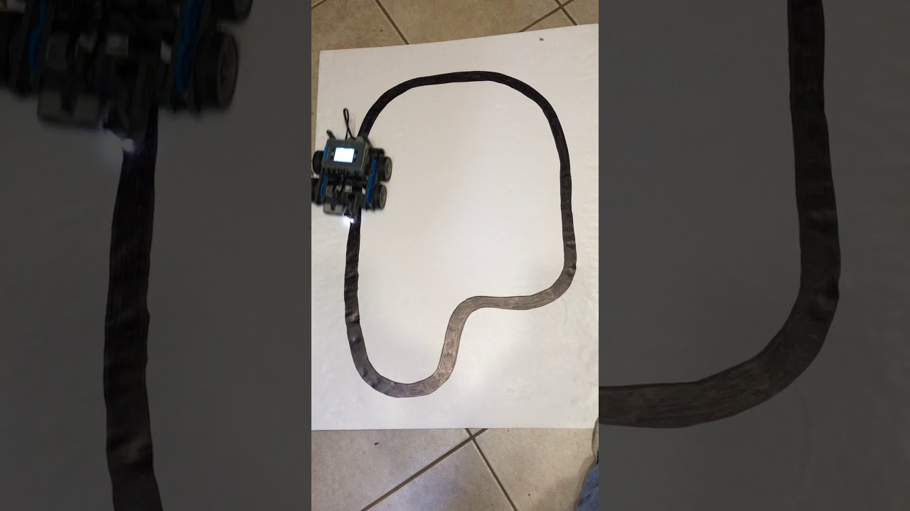

Here’s an iq line follower in action. It checks the sensor and turns left (about 30 degrees total) if the sensor detects white. If it does not find black color after turning left, it turns right. It would be better if there were 2 sensors. Then you could tell which way to turn by seeing which sensor detected white first.
