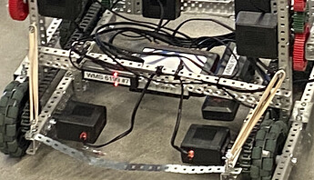

Ok we need a little help… a lot actually so we have a comp tomorrow and our forebers aren’t functioning. They go down but not up. the moters can hold it up because our anti gav is in effect. Basically everything works except for lifting. We have a simple build fo it. we have 4 motors 2 red 2 green each with a piece of metal attached then they are all linked up correctly. If anyone can help please do this is urgent. our code looks like this/----------------------------------------------------------------------------/

Why on earth are you using 4 motors for a four bar? And why are they different speeds? No wonder why it’s not working. Are you powering each joint individually or something? Four bars only have 1 DOF. You would be greatly overconstraining the mechanism if you were. Please send pics
also your code has some major issues.
instead of using while loops to control the lift, you should use if statements.

and instead of moving your motors up slowly to counter the lift from sinking when not powered, you can set the braketype of the motors to hold, which makes them actively work to maintain their current position.

But as @Ethan5956F pointed out, it sounds like you have very severe mechanical problems with the lift that mean it’s very possible it won’t work regardless of how functional the code is.
forebar
Hi, we are 6199E’s sister team here is a picture of their robot:
It is so much worse than I imagined.
This is very unlucky. I would recommend rebuilding and looking at some resources for how to build a fourbar. Maybe look up some reveals from other teams this season. Hope this helps.
Simply bad luck.
given you have a competition tomorrow, I am not sure how many hours you can spend rebuilding your robot today.
remove four motors from your lift/arms. Keep two red motors and connect to drive the green gears in your picture.
BTW do you use bearing flat?
Here is Xenon27’s code with more detail. Do not forget to reverse one of the motors.

i’m not completely sure if you should even be using that 4 bar for a comp because it might damage the motors (different speeds). And you can’t really get any more motors.
Good luck at comp
Did you use tri banding, that might help
That lift simply will not work in its current state.
these might be helpful in understanding why:
Your main problem point is the fact that you are using 4 motors with different speeds in an attempt to direct drive a lift. The motors on their own have way too much speed and not nearly enough torque to power something like a lift, you need to use gear ratios to increase that torque at the expense of speed. A good place to start would be to power 12 tooth gears using red motors, which turn 84 tooth gears on the arm. This will get you a 12:84 (1:7 simplified) gear ratio, meaning that for every rotation of the motor, your arm will rotate only 1/7 as far, but with 7 times the strength.
it is also important to note that you should never be forcing two motors of different speeds to run at the same mechanically, this can be damaging to the motors and will be largely ineffective at solving any problems.

what purpose could these rubber bands possibly serve

From a structural point of view - it may be good to watch and understand how 4-bar and 6-bar lifts work:

I would not think too much into the quirks of this robot given the more pressing issues. It’s clear that this team is inexperienced and still learning, and that’s good. Let them learn that rubber bands are not good lift braces the hard way.

In terms of this post, pretty much all I can say is what the others said, having 4 motors for a 4-bar is too excessive, and as @Xenon27 mentioned, this could damage your robot with the different speeds of motors. I would suggest a 2 motor or even 1 motor lift, with 100rpm (that’s the red one) driving the 12-tooth gear and having it connected to a 60-tooth or 84-tooth gear which would then connect to your arm. You could save two motors for other important things, such as a conveyor belt or a back tilter.
