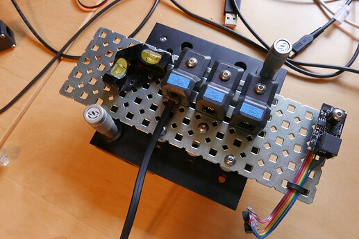

Attach the Inertial sensor to suitable VEX structure (C channel etc) and place on a level surface, use a spirit level to ensure the surface is in fact level as best you can. Here is the setup I use, this is somewhat overkill, but it allows me to have easy adjustment for leveling the surface.
Connect the Inertial sensor to the V5, open the V5 dashboard, press and hold the calibrate button on the dashboard for about 10 seconds, it will turn red and show the word “Factory” next to the calibrate label, stop touching the V5 screen when the button turns red.

Now touch the red calibrate button again, the inertial sensor will calibrate for about 2 seconds and then return to the normal dashboard screen.

Values for the accelerometer, roll and pitch should now show normal values for an Inertial sensor on a level surface.
