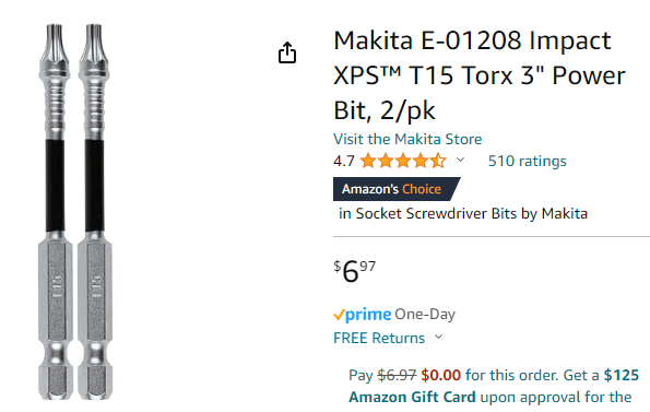

If you look, you can find a torx t15 tip that will reach ALL the way through a 1x3 c-channel.

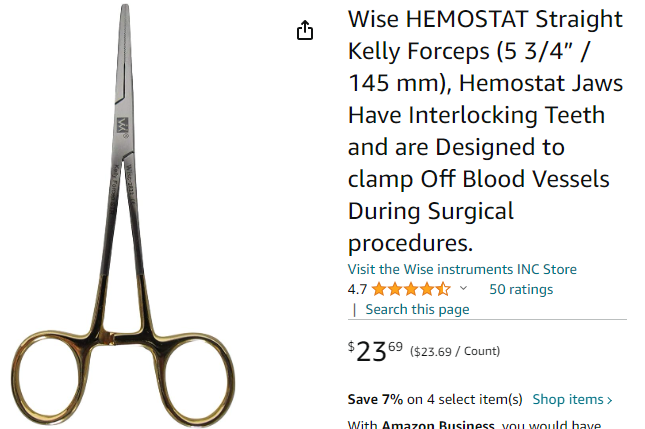

These will allow you to speed up assembly more than any single item you will ever buy. This is a premium pair. You can get cheaper ones.

forgive my naivete but what are the forceps for?
Pretty much everything… like another pair of fingers.
Need to put a spacer on an axle in a tight spot?
Need to hold a nut where you can’t get a wrench on it?
Have a chain lift and need to ‘fish’ the chain through a tight spot?
etc.
We occasionally use them to place a nut or machine screw in tight places where fingers do not fit.
