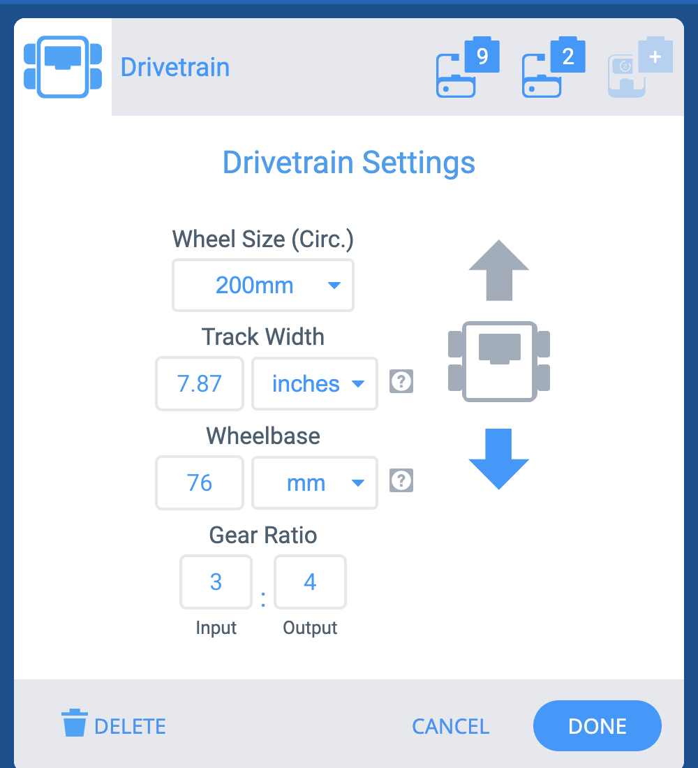

The team tried to speed up the robot from the original direct motor to wheel set-up to gearing with a 3:4 ratio only on the front wheels.
Speed increased and is great, however turning velocity now seems too high and makes aiming the arm/intake very difficult. From what I understand the remote overwrites any turn velocity reduction coded.
Are there any options to keep the speed but increase turn accuracy? Otherwise the team might have to switch back to the direct motor set-up. Any other options for the gearing to slow it down a little more but still have an advantage in speed compared to direct motor?
Figured I would ask first, before giving up on the set-up.
The gear ratio on the drive train was reversed. It should say Input 4 and Output 3, however that didn’t seem to make a difference when it comes to turn handling.

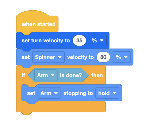

You can individually change the turning and the driving velocity in vex code.

I may be wrong, but set velocity does impact the drive controller using the default drivetrain program.
Other post in the past you could skip the drivetrain setup but you would need to program in code when joystick down drive reverse, etc commands.
Drivetrain set velocity (may be wrong) only impacts autonomous program drives (and turn velocity also).

Idk just set the velocity to something lower to make whatever you want slower and it only impacts that motor/motor group
