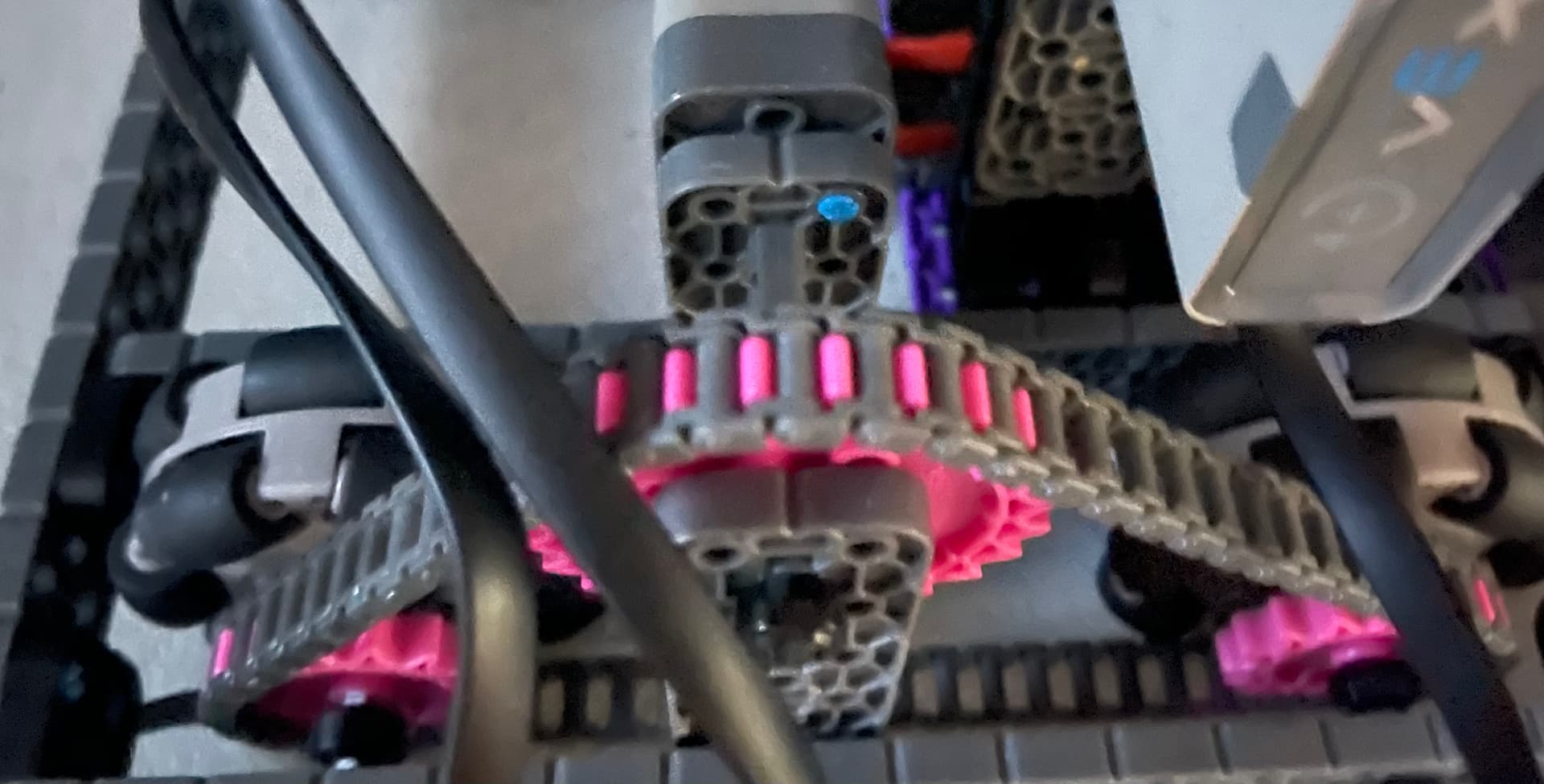

New to this, please help me understand gear and sprocket ratios. I am having a hard time determining what is driving vs driven to do the formula of driven/driving. I have a drive train that is using 2 16 tooth sprockets and one 24 tooth sprocket per side…. The motor is connected to the 24 and the 2 16 tooth sprockets are connected to the tires by a axel… is the driving the one being operated by the motor? 1:5

Usually, the first gear is a “drive gear” attached to the motor shaft and the second is a “driven gear” attached to the load shaft.
The 24 tooth gear is the drive gear. The 16 tooth gears are the driven gears. This means your ratio is 24:16 or 3:2. So your wheels will be spinning 150 rpm if the motor is spinning 100 rpm.
