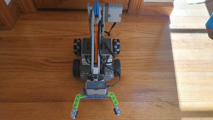

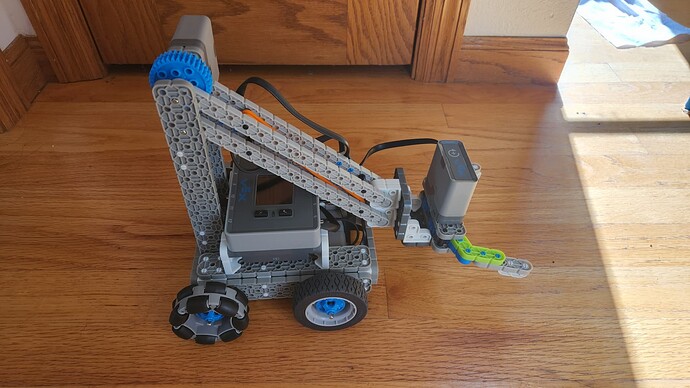

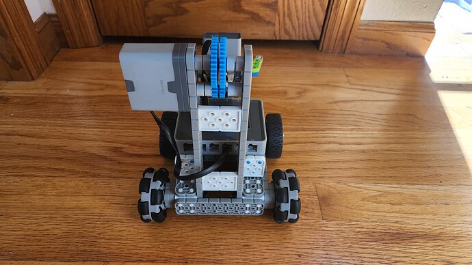

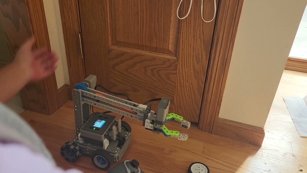

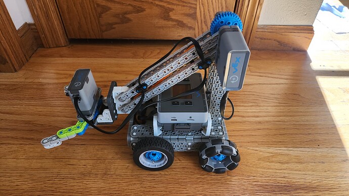

Some photos from various angles (the claws are probably off by one gear tooth):
The Clawbot is a starting point, not a perfect finished build. It uses a small percentage of the structural parts in the kit. The robot is a trainer that is there to give you ideas. You are on the right lines though, so can you improve the bracing?
The arm motor will be in hold mode, it is always working to hold the arm in the position you move it to. This draws current all the time so it’ll get warm to the touch, but not in a way that’ll cause a problem. You can always write some code to turn hold mode off though.
As for the jerky movements, seems odd. The joysticks are analogue and you can drive the motors very slow, just a couple of RPM if desired. Can you post a video of the movement issue?
