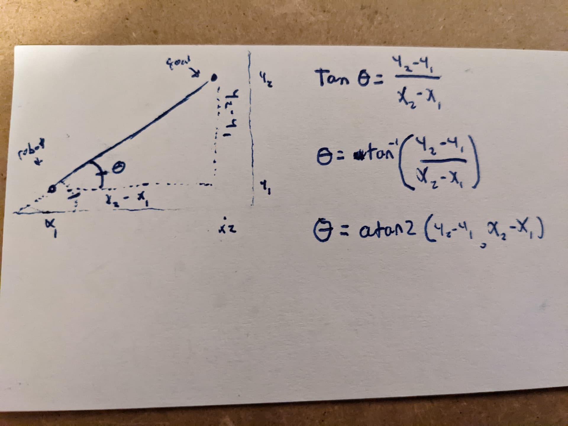

Hiya everyone! I have a question about the GPS sensor. How do I make it so that it turns the robot to a specific X and Y coordinate? Me and my team have gotten the coordinates for the goals, so we’re trying to make it so that you can just press a button and the entire robot turns towards that goal. Thanks as always!
You are going to need to use trigonometry, more specifically arc tan, that should give you the angle from one point to another using the difference between the x and y coordinates. Then make the robot face that angle
To add on to what @7996B is saying, if (x1, y1) is the position of your robot, and (x2, y2) is the position you want to face, you can calculate the angle you want to turn to using this function, with these inputs.
