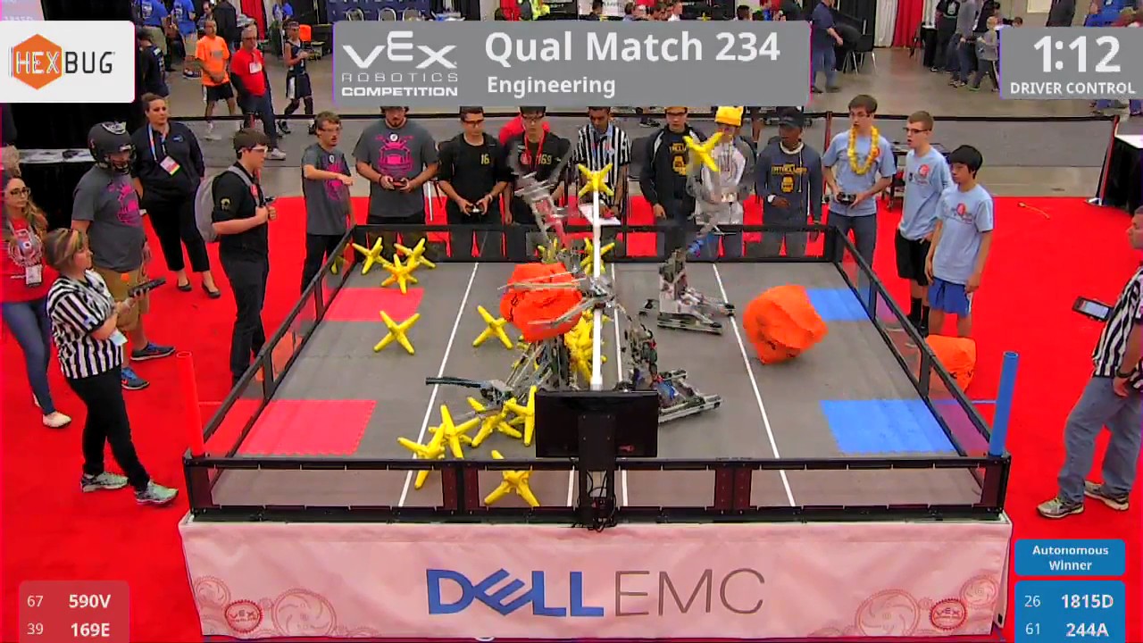

EDIT//: My robot was 1815D for that season. (Also I have just realized that the announcers almost always swap the last two numbers of my team number. The same thing happened this season during ITZ with 1814D…)
Here is a match of our robot in StarStruck that uses a gyroscope and time, nothing else. This autonomous, when ran, is the most undefeated autonomous at VEX Worlds 2017 in the division. It only had to turn twice, which considering the minimal amount of turns as well as simplistic turns, the gyroscope out-performed a quadature encoder for turning especially with the fact that the robot tips slightly while lifting such a heavy load.
Here’s my thoughts for this season, and after last season when using time and a gyroscope as well:
With more movement that is involved, there’s more room for error. My robot for ITZ could have been more consistent if it didn’t use time because the IME’s didn’t work consistently on my drivetrain. Other than the time factor, I have had a very positive review with the gyroscope and its consistency at turning at the correct angle, as long are you reset the gyroscope before making a turn. Although I will say I have a positive review on the gyroscope and its consistency on my robot, if you’re using more complex movements and turns, that is where I would draw the line and try my best to make the program consider using a gyroscope with shaft encoders for improved consistency, or otherwise not use gyroscopes and go full-on shaft encoders.

“most undefeated autonomous at VEX Worlds 2017 in the division”
XD
After double checking the Engineering division at VEX Worlds 2017, this statement is true. Also there has never been a match that my robot lost an autonomous when that specific autonomous from the video posted above was ran.
