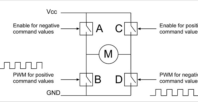

[ATTACH]7592[/ATTACH]
The H-Bridge consists of four switches, they are shown above in pictorial form. The implementation in the cortex uses MOSFETs, two P channel on the high side (shown as A and C here) and two N channel on the low side ( B and D ).
[ATTACH]7593[/ATTACH]
To turn the motor forwards (which way is forwards is subjective and not important here), switches B and C are closed. This creates an electrical circuit through the motor as shown on the diagram above.
To turn the motor backwards, switches A and D are closed. This creates an electrical circuit where the polarity across the motor is now reversed.
Closing either switches A and B or C and D at the same time will connect positive voltage source to ground as shown in the third diagram above. This is something you do not want to do, it has the potential to seriously damage the H-Bridge components.
[ATTACH]7594[/ATTACH]
This shows in more details how the H-Bridge in the cortex is connected. Switches A and C are connected to two control lines I’m calling enables. These will either be on or off depending on the required motor direction. To allow variable speed control of the motor, the other two MOSFETs are connected to control signals that can be pulse width modulated, that is, toggled very fast between on and off. The speed that the pwm signals are toggled is determined by the cortex firmware but is typically about 1000Hz to 1200Hz.
[ATTACH]7595[/ATTACH]
(This explanation is for illustrative purposes and not quite how things work, it’s close enough however).

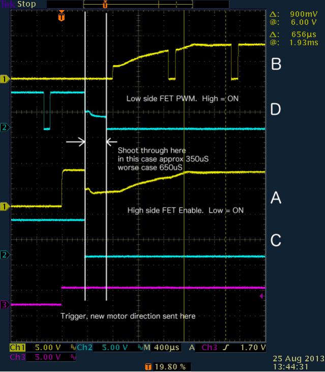

So first lets look at the control signals that PROS is currently generating for the H-Bridge. I know they are currently working on improving this but I wanted to show the details and make an argument that I’m not actually paranoid.
[ATTACH]7596[/ATTACH]
This is a rather complex composite scope capture showing the four control signals going to an H-Bridge when changing direction from backwards to forwards.
The Pink trace was generated by a digital output when the software asked for the new motor value. The yellow trace labeled A shows the enable signal for backward is turned off (reverse logic, high is off here). 350uS later the blue trace labeled as C turns on the enable for the forwards motion, however, the pwm control line for backwards D is still turned on as the timer controlling pwm is running asynchronously to the software. This causes the undesired shoot through situation where the battery is shorted to ground. Traces A and B both take some time to recover due to the power supply used for this experiment being in current limit mode to save my cortex from making magic smoke. As the PWM frequency here is about 1KHz, the maximum time that shoot through could occur for is 650uS if motor values of +/- 127 were being used.

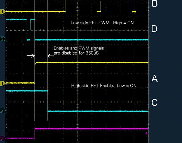

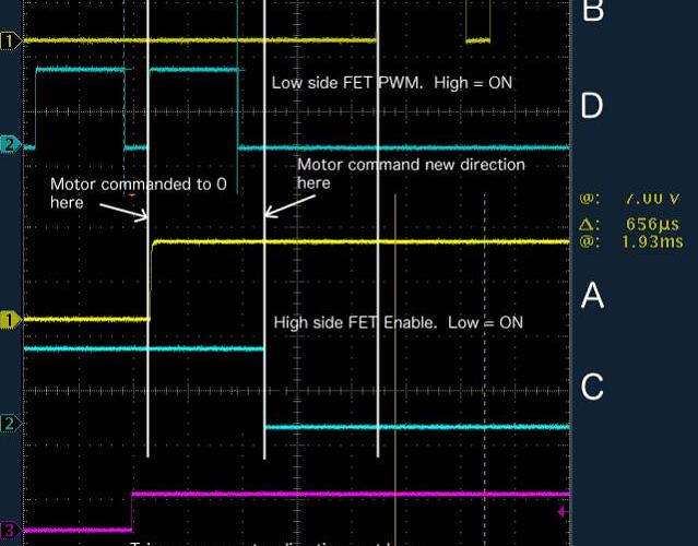

[ATTACH]7597[/ATTACH]
Here are the control signals coming from firmware with a different method of control (yes ConVEX). In this software the enable signals are made synchronous with the pwm signals. This is achieved by using an interrupt generated from the pwm timer to run the software controlling the motors. A change of direction first causes MOSFET A to be turned off for one entire pwm cycle before MOSFET C is turned on. In addition to this pwm values are commanded to be zero for one pwm cycle. Due to the nature of the compare preload register’s operation, a one cycle delay occurs before both pwm signals are essentially disabled. Motor power is restored after one more cycle. What this means is that when the motor changes direction it is disabled for two pwm cycles before resuming operation. The pwm in this example runs at 1200Hz so the delay is negligible in normal operation and only occurs when changing motor direction.
Anyway, this is my suggested way of H-Bridge control that avoids any possible chance of shoot through. A simpler, but in my opinion less effective means, is to increase the delay between disabling and re-enable the enable control lines to more than one pwm cycle. In the case of PROS this would mean increasing the delay from 350uS to perhaps 1.1mS.

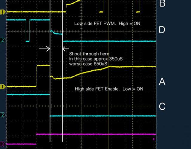

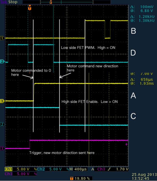

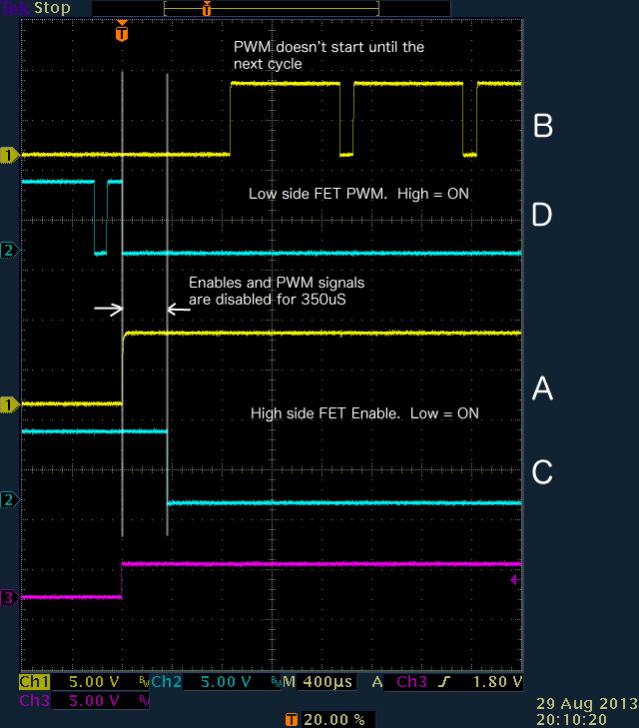

I wanted to conclude this thread by showing the improvement the PROS team has made with the firmware released on Aug 26 (2b04). Here is another capture under the same conditions as post #1.
[ATTACH]7608[/ATTACH]
Their approach was to disable all four control signals to the H-Bridge when motor direction changes and also disable the pwm until the beginning of the next pwm cycle.
All H-Bridge shoot through is now eliminated :slight_smile:
