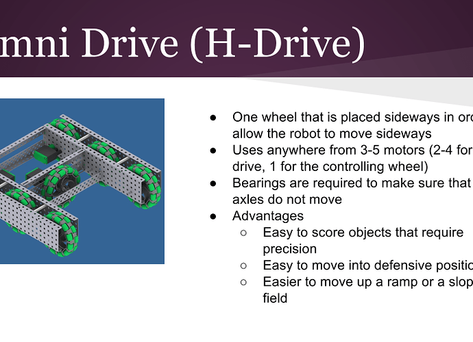

H-Drive?
hello, im trying to design a 3-motor h-drive with omniwheels. how would i code the drive system to be able to drive forwards, backwards, sideways, and rotate around the middle? here is a picture of the base im trying to base my design off of:
if possible i want a way to limit the controls to one joystick for forward, backwards, and rotation around the center. sideways motion can be controlled by a L and R button on the Joystick controller
If you are going to use the left joystick to control forward, backward, and rotation, you would need to set the back right motor to channel 3 - channel 4 and the back left motor to channel 3 + channel 4. This would mean that when channel 3 is forward all the way, both the left and right motors will move forward. Then if channel 4 is to one side all the way, the right and left motors will spin opposite of each other. I have never build an H drive before so I’m not sure if it would rotate around the center. If you are planning on using 3 wheels per side, then powering the middle wheel would make it most likely to rotate around the center wheel. To program the middle wheel, you could make some if statements for the L and R buttons that sets the middle motor to specific values such as 127 and -127. I have only used PROS to program so I’m not sure how useful sample code would be for you but I can write some if you need more help.
all the wheels on the same side will be connected to a single motor. but what youre saying is to essentially use a standard arcade tank drive code plus a two button statement?
I would think that would work best. I’m not sure how well connecting all the wheels together on each side will work with turning but it should work.
Exactly. Although I would suggest using a joystick to control speed of the sideways drive, but I guess you can use buttons if you wanted.

yes, exactly that is why im trying to avoid the second stick. it controls the arm of the bot. im at a school and we cant afford the partner-controller
this is the type of solution that would be useful to me. how would i code this
is this a good starting point? for defining the two different drive modes, ill add the second drivemode soon

While (1=1){
LeftDrive = JoyVERT + ((1-BtnSHFT)*JoyHORZ)
RightDrive = JoyVERT - ((1-BtnSHFT)*JoyHORZ)
CrabDrive = BtnSHFT * JoyHORZ
Something like that should make it so that when your shift button is NOT pressed, side to side would rotate the robot, and when the shift button IS pressed, you would strafe.
is that even capable of being used on the vexRT system? the whole “JoyVERT and joyHORZ and BtnSHFT?”
Those are probably just placeholders for whatever you decide to use as the joystick channels/button.
