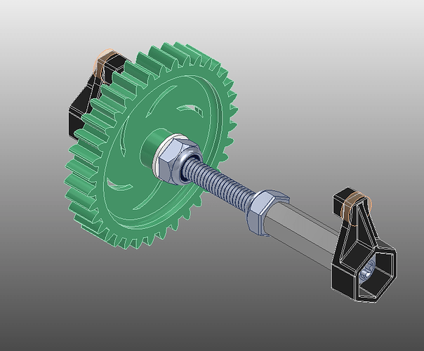

In your setup, the standoff is tightened to the locknut. I find this to be the best way to do screwjoints. We are using this method on some of the idler gears in the drive, seen below.
A locknut couldn’t fit in this assembly between the wheel and standoff without using a screw longer then 2". Even though 2.5" screws are legal now, we didn’t want to force teams who are referencing this robot to buy longer then 2" screws, as VEX doesn’t sell them yet.
The exposed screw in the image below is all of the space available, and wasn’t enough for a locknut.
If the standoff is sufficiently tightened to the outer channel then this shouldn’t come loose, but a little bit of purple loctite never hurts.
If the standoff isn’t tightened enough to the outer channel, the standoff could tighten itself to the wheel and jam the drive.
Thanks, I know my team had issues finding the right spacing with the standoff joints because it changed depending on how much it was tightened, an extra turn might mean a washer. I am assuming this is a common problem that just needs to be practiced a lot.
Yeah, I usually place my outer channel on and see how all the standoffs align and tune all of them until the locknuts are in the right place. After this first tuning, you shouldn’t need to mess with the locknut placement again. Could also put temporary standoffs in the drive and adjust the locknuts until everything contacts, then remove those standoffs.

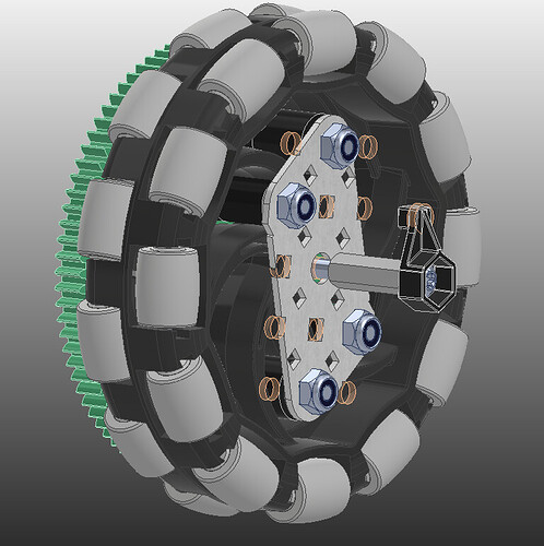

Slightly confused here however: on the CAD for the AMOGO drive train, how do the wheels turn? Don’t keps nuts keep the screw tightened against the C-Channel? Or do we have to assemble it a special way?
What makes this assembly better than the usual drive train assembly with shafts?
Yes the keeps nut does keep the screw firmly attached to the C-Channel. This is what they want to happen. it is used to create a fixed axle that is very conveniently a circle. This means less friction, which is good very good. Because friction is bad, very bad (for moving parts (most of the time))
The screw is being used as a fixed axle that is effectively part of the C-Channel. The wheel has circle inserts so that it spins freely and is powered because it has been screwed to the sprocket.
Welcome to the community!
Thank you!
These are called screw joints. The keps nut is tightened to the inner channel, and the standoff is tightened to the outer channel. If the space between the keps nut and standoff is greater then your wheel assembly, it’ll be low friction and free spin. If your keps nut / standoff are tight, then nothing should come loose.
When building a drive, if you just screw the drive pontoons (“pontoon” refers to the inner and outer drive channel as an assembly) to your cross brace, you’ll find that the drive pontoons don’t want to stay square. This is because screws don’t fit perfectly in the square holes of c-channels. This can be mitigated by using shoulder screws, but doesn’t entirely fix it. (it’s good practice to use shoulder screws though)
Having something that ensures the distance between the inner and outer drive channel is the same all the way across is essential for your drive to have low friction. If they aren’t, then anything you build on top of that risks not being square and your drive axels increase in friction or will struggle to drive straight.
Usually this is done by having standoffs that go between the inner and outer channel, but when you run gears all the way along the drive you lose a lot of holes to put standoffs. By using this style of screw joint for the wheels and unpowered idler gears, the joints are keeping the inner and outer drive square.
When putting standoffs inside of drive pontoons, the spacing is never a clean standoff size. It’s always a size down standoff from what almost fits, a spacer and some washers. This changes a bit if you’re using steel or aluminum, mixing both, or the direction of your drive channels, so be sure to check CAD for your setup to get as close as you can to the correct spacing.
Before I mount the outer channel, I tighten all my long screws to the inner channel. I’ll make one wheel assembly with some spacing, put the standoff on loose, then attach my outer channel. At this point, only 1 wheel is mounted, and I see if everything lines up and if my spacing is correct (it never is first try). After the spacing is good, I’ll mount all of my wheels.
When tightening the standoff, it’s important to tighten it to the outer channel, using pliers or a wrenchy wrench. If you don’t, it’ll tighten to the wheel stop it from spinning. A bit of purple Loctite on the screw between the outer channel and standoff will help make sure that screw doesn’t come loose and is still removable for drive maintenance.
The keps nut on the inside shouldn’t come loose if tightened enough, but this can be replaced with a locknut (normal or thin) and then definitely won’t come loose.

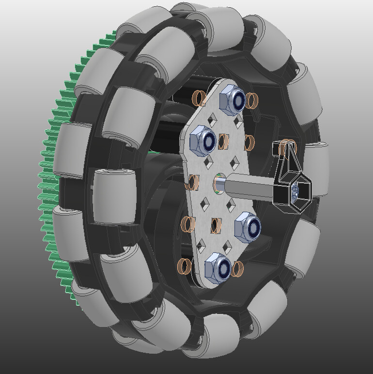

While building the chassis, while we were building it according to the design, we ran into an issue. It told us to run a circle screw through a square insert.
This is the link to the screenshot that we saw in Autodesk
My team is quite confused about this. Can you help out?
This is the picture of the square insert on the gear
The gear is drilled out in the center to allow it to spin on the screw. It was omitted from the cad design since in most cases it wouldn’t be seen.
