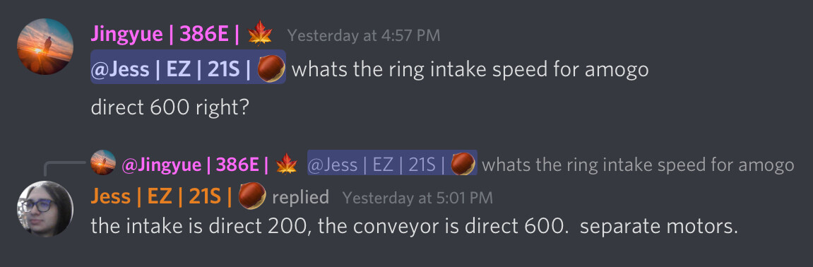

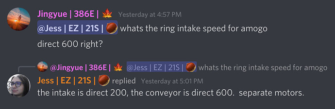

I love the ringle intake on AMOGO, what rpm does it run at and which cartridge is used for it?
(Taken from VTOW)

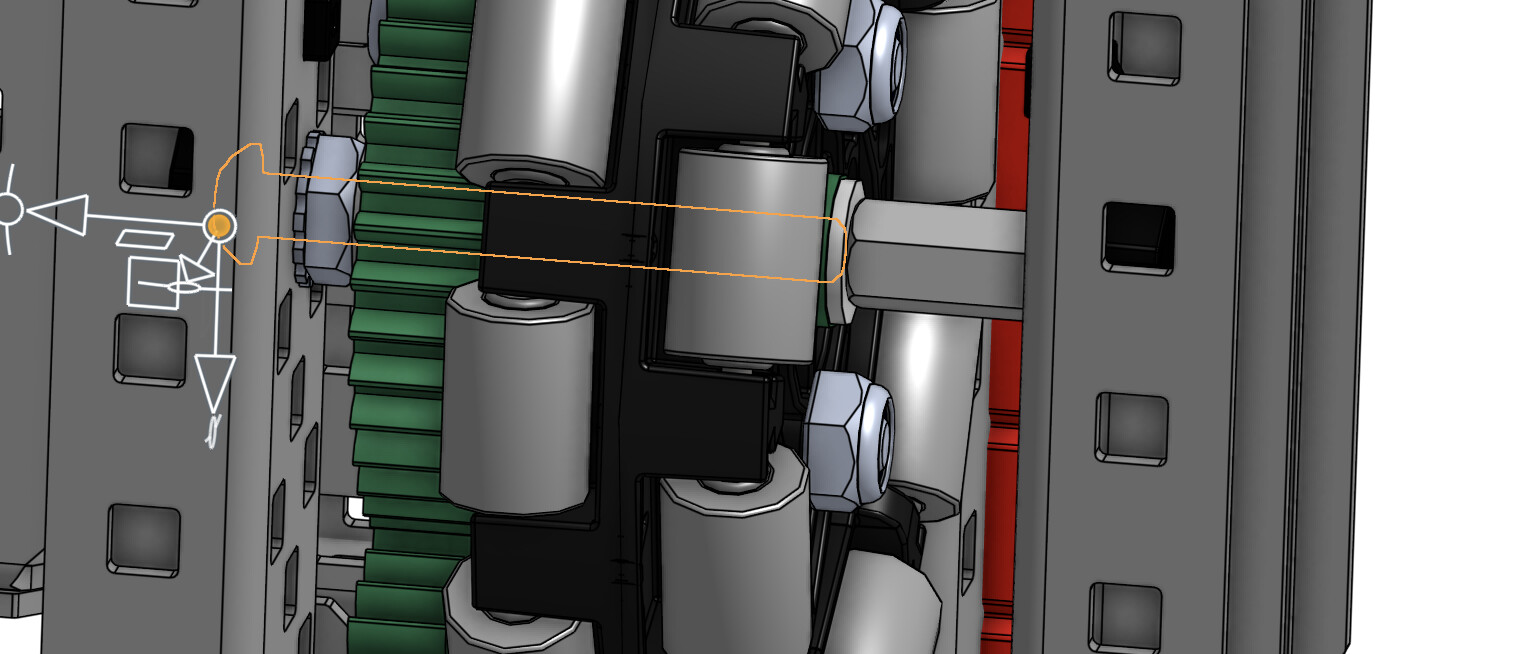

Thank you for all the work that you put into these robots, and especially for posting the CAD models. I’ve been trying to get my students to use CAD for a few years, without much luck. I took your STEP files, imported them into Onshape, cleaned up some conversion issues, and then showed the kids where they were. Within a few minutes, I had ten kids using CAD for the first time. They still need to make the leap from looking at CAD to creating their own designs in it, but it’s a start.
In addition to learning CAD, they are picking up a lot of new building techniques. However, they did have some questions that I couldn’t answer and they are kind of young to be posting on the forum. Here are their questions regarding AMOGO:
  1. The model shows a 1.5" bolt for the wheel axles, which means it is just slightly too short to attach to the standoff on the other side. Is that intentional? They are using a 1.75" bolt instead.
  1. The screw axle fits tightly and is difficult to turn. Is that also intentional? They are filing down the threads on the screws where they go through the gear and wheel.
Thanks again!
Onshape users - here are links to the Onshape versions of the CAD models. These versions will perform much better than straight imports of the STEP files.
AMOGO: Onshape
DOGO: Onshape
Hi,
This is a 2" screw.
Hex screws are thicker then star screws. Circular inserts spin on star screws much easier then hex screws. If using hex screws, either drill the green insert with a #19 drill bit or near size. In the wheel assembly, make sure there’s only 2 green inserts, both on the outer sides of the wheels. Having more points of contact increases the likelihood that they aren’t aligned, and increases friction.
Make sure that the standoff is tightened to the outer channel, the screw is tightened to the inner channel, and there’s enough space in the middle for the wheel to spin nicely.

One question about the screw joint with the 4" wheels. In your cad, it goes 2" screw with keps, through wheel, washer, standoff to c-channel. We built most of our screw joints with Screw, keps, through wheel,washer and then nylock to hold in place and then standoff. Does it stay in place without the nylock?
