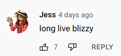

genuine question: is it blizzy or bullseye?
blizzy of course, even jess endorses this:

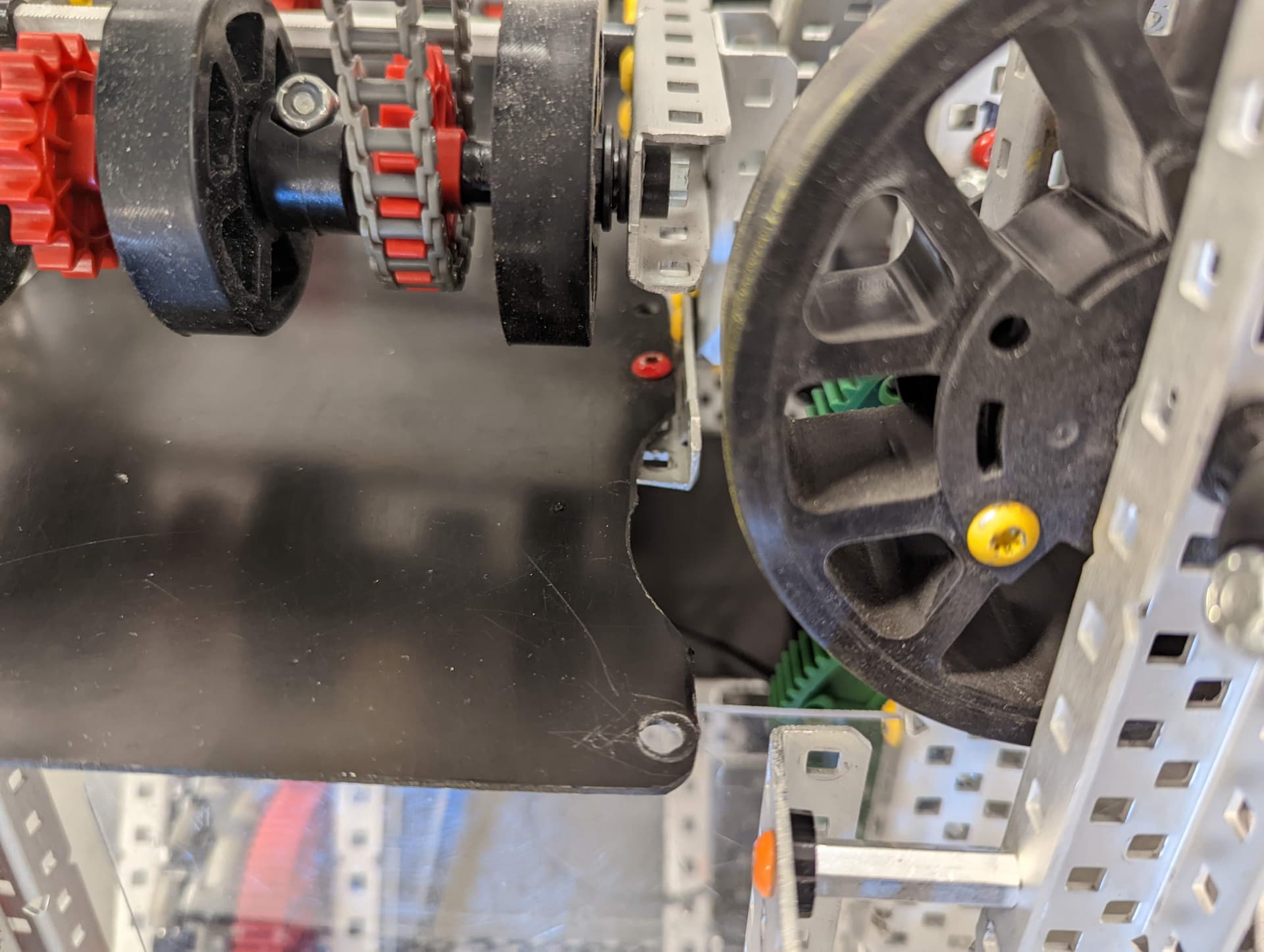

Hi I was wondering why having a steeper intake was preferable. Is it just because of increased space in the back to use?
It is bullseye but blizzy is funny :slight_smile:
haha blizzy
For me at least, it’s for that reason. Having a more shallow angle is a lot easier to intake, but it takes up a lot more space at the same time. Having a steeper angle is harder to get working consistently but it saves a lot of space
In
I think this is a 60T gear ? or maybe I’m wrong.

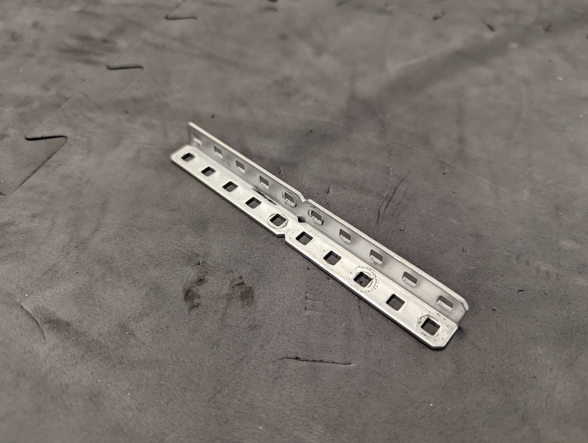

Thank you, everyone, for pointing out the size issue. We apologize for not recognizing this sooner. We have created a new video outlining how to get BLZ-i into size. Hopefully, this allows BLZ-i to be a viable solution to this game.
One thing we found after shooting the video is it is essential to remove a bar on the intake. If you look at the picture below, the 10-hole 1x1 should be removed from the bottom of the intake. We hope this fixes the problem.
Here is the link to the new video: 14 Sizing Fix It - WATCH FIRST - YouTube
