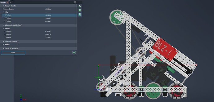

I believe BLZ-i and MARC will both be meta bots for the whole year if an endgame mechanism is attached similar to the ring intake in the DOGO. One concern I have is that the angled shooter seems to protrude out of the 18x18x18 limit, is that so or am I just going crazy? I love the work you guys put in to help inspire veterans and rookies of VRC through the engineering design process. I wish you kids the best in all future endeavors.

Does this bot fit within the 18in? Inventor says no…
not to mention it looks like it expands horizontally (very slightly) when picking up discs

at the very least this forces teams to innovate to make it fit within the limits
Yes, however I am only pointing it out because it wasn’t mentioned. Also, none of the creators have said the CAD is wrong. Many, many teams are going to build this robot, and expect to have a competition legal robot. This robot is supposed to be competitive, I would assume it would be able to compete, no? Should there not be a disclaimer saying, hey, this robot you are about to build is like 2 inches over the size limit, get ready to do some MAJOR modifications. I love the work that this team has put in the past two years, and the instructions are extremely easy to follow, a great resource, and such a great addition. It just needs to be made clear that this competitive robot can’t compete.
