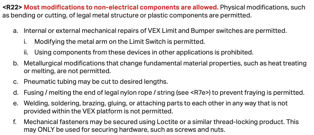

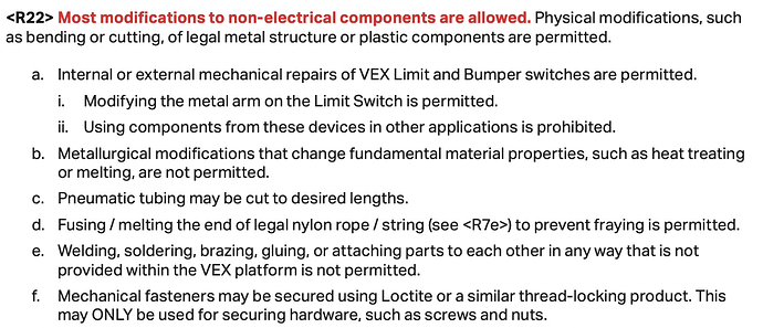

It is fairly noticeable. By about a mm or two. Is it legal to shave down the sprockets?
You can find the answer to that in the game manual, more specifically R22
Yes
