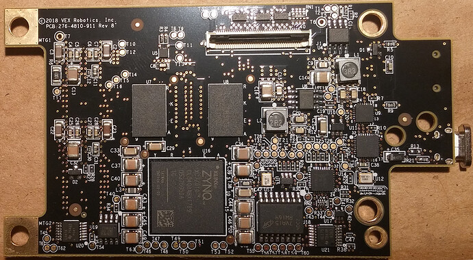

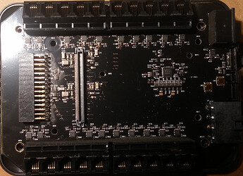

Here’s some shots from a while ago of the processor on the V5 brain. It is only around 20mm x 20mm and permanently soldered in. I’m curious as to what you think about ’
You can pretty easily get around most of those, but that’s not saying it will work well (or at all).

Looking at the photos I reposted earlier, the RAM is permanently soldered, but I have seen instances of people adding higher density chips in their place. But, the fact of the matter is that there is no support built into the firmware to make this work.
It probably would be better to find a way to flash linux to it and run a very light version of early windows in a VM. But good luck finding a way to access vex’s config files for the VEXos. IF everything else works, you could find a way to just use the micro USB, as it is just USB, but… micro. There are some off the shelf dongles and adaptors that can do this for you. I don’t know if it’s set up correctly for this use, though, as I am no PCB design expert or have access to vex’s proprietary firmware.
I love @Bubski 's rPi idea, and I have another thing to add: You could use a Pi Pico for its small size and find a way to interface it with the power distribution board in the brain and the screen. ( you’d just have to find the usage of all of those pins in the ribbon cables from the processor board to the display and the PD board.

Look up that thing labeled Zynq. It isn’t an A9 processor. It is a SoC chip from Xilinx that has a huge FGPA + processor. There’s an immense amount of IO capability in that SoC plus parallel processing from the FPGA fabric that you can’t duplicate in an off the shelf processor.
Blockquote Seriously, they’re expensive
You should look up the price of the Zynq part before saying this. I’m working on projects using UltraScale+ (a bigger brother to this), but $300 seems cheap in my world. You’re not buying a little processor in a plastic box for this price. You’re buying boatloads of simultaneous IO and all the driver chips to go with it.
