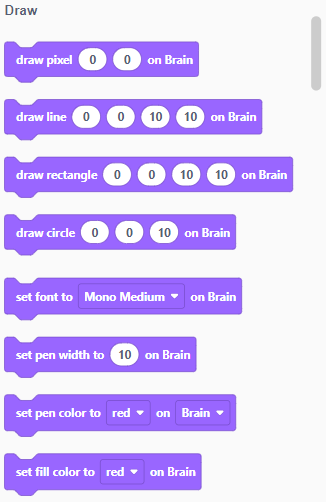

480x240 (excluding the 32-pixel status bar at the top)
There are multiple functions that allow you to draw on the screen, as shown below.
If you use C++ or Python, the art can be designed on your computer and displayed on the Brain with one line of code. A MicroSD card is necessary to do it like that; read this topic for more details.
