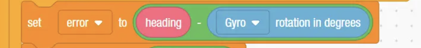

We were following the tutorial by team Caution Tape(@gamania), but realized it used the external gyro sensor. I was wondering if anyone has a version that works with the internal V2 brain sensor. I tried just replacing the part, but my robot is not preforming the desired behavor at all.
Original tutorial:

Left motor velocity = Heading - gyrorotation
Change to
Left motor velocity =Heading + Output

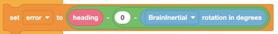

If you want to change the gyro to an inertial sensor you can use this code.
In this area, you should switch the “Gyro rotation in degrees” for this.
See if that works, and if it doesn’t, try sending a video of what is happening along with your code
Thanks
Hi Penguin,
Could you explain why the minus 0 is needed? Am I subtracting the rotation from 0 to flip the rotation?
The 0 - BrainInertial rotation in degrees is so that it reverses the value that is coming in.
Ex. The brain inertial gets that it is rotated 35 degrees, if you do 0 - BrainInertial rotation in degrees it will be -35. So it reverses the output allowing for minimal changes to your code.
